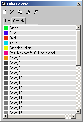

To use the palette to choose a color:
  • On the List or Swatch panel, click the color.
    The color appears as the active color on the VertexPaint Paintbox, in the swatch just below the Erase button.
To change the color of a color swatch:
  1. Double-click the swatch.
    A Color Selector appears.
  2. Use the Color Selector to change the swatch's color.
    This version of the Color Selector is modeless, so after choosing a color you can either close it, or leave it open to change another swatch.
To use the color picker:
  1. In the Palette's List panel, highlight the name of a color.
  2. Click (Color Picker) to turn it on.
    The cursor changes to an eyedropper icon.
  3. Without depressing the mouse button, drag to an area where you want to pick a color.
    You can obtain colors from viewports, the 3ds Max user interface, or anywhere on the Windows desktop.
  4. When you depress the mouse button, the picker obtains the color below the cursor. You can drag while the mouse button is depressed. While you do, the color swatch in the palette and the larger swatch on the Paintbox update.
  5. Release the mouse to pick the color you want.
    The color in the Palette and the active color in the Paintbox are both updated.
To change a color's name:
  1. In the List panel, click the name twice (more slowly than a double-click).
    The name changes to an editable field.
  2. Enter a new name or edit the existing one, and then press Enter.
    Press Esc to cancel the name change.

Color Picker
Highlight a color in the palette, turn this button on to activate the picker, then drag anywhere on the Windows desktop. The color is picked when you release the mouse. (See the procedure “To use the color picker,” above.)
List panel
Displays the colors in the palette, along with their names.
Swatch panel
Displays the colors in the active palette. The swatch panel doesn't list the names of colors, but each color's name appear as a tooltip when the mouse is over the swatch.
