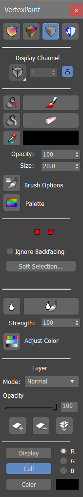

VertexPaint Paintbox
The VertexPaint modifier's Paintbox is a floating toolbox with various vertex painting tools. The Paintbox is launched automatically after the VertexPaint modifier has been applied to one or more objects. You can close the Paintbox by clicking the X button in the upper-right corner of its window. To open it again, click the Edit button in the Parameters rollout of the VertexPaint Modifier

Interface
Vertex color display buttons
Control the display of the vertex paint in the viewport by using the four icons at the top of the floating panel. You can easily switch between shaded and unshaded vertex color modes, or turn off the display of vertex color and or texture maps.
Note: The first three of these buttons stay highlighted when you click them, to indicate which shading mode is active. Toggle Texture Display simply performs the action without becoming highlighted.
Note: These controls have no effect on wireframe viewports, but work for all shaded viewports, including Lit Wireframe.

Display Channel group
These controls let you select which one of the map channels to paint on:
Map channel display in viewport flyout
  • Vertex colors Choosing this lets you display the vertex color channel in the viewport.
  • Vertex alpha Choosing this lets you display and paint the vertex transparency channel in the viewport.
  • Vertex Illum Choosing this lets you display and paint the vertex lighting channel in the viewport.
  • Map Channel Choosing this lets you define a numbered map channel to paint on. Define the channel ID number with the Map Channel Display spinner.
What you see is what you paint, so whatever you select will both be displayed and activated for painting.

Vertex paintbrush group
Vertex paintbrush controls
Here are the controls that let you access the paintbrush and the paint. You can choose color to paint with, from a color selector or from the scene. Choose to adjust the brush size or envelope, or launch advanced paintbrush options such as pressure sensitivity.
Paint All
Performs a traditional paint fill operation on the current object or sub-object selection. In the case of sub-object selections (vertices, faces, elements) the fill will honor those selections. In the case of soft-selections Paint all will do a “faded” fill, slowly tapering off the opacity based on the soft selection settings.

Paint
Starts the painting process. Once it is turned on, you can start painting on the current selection, by moving the cursor into the viewport and over the object.
If there is a Vertex Paint modifier highlighted in the Modify panel, you will be painting into that layer. But if the selected objects do not currently have a vertex paint layer highlighted in the modify panel, then a dialog appears letting you create a new modifier. This will be instanced across all the selected objects.
You will not see the results of your brush strokes, unless the proper display mode is set (above) Be sure your display mode and your paint target match. For example – if you are painting on the alpha channel, be sure you are displaying the alpha channel. If you are painting on the color channel, display the color channel. Brush strokes will use the color specified in the color swatch directly below the Paint button.
See Painter Options Dialog for more painting options.

Pick color from object
Allows you to choose a color from the currently selected objects. The color is taken from a single vertex; region selection is not supported. The choice must occur near a vertex, or no color will be chosen. You can drag across a vertex of interest to pick up its color. Because this button enters a mode, it must be clicked to leave the mode, or you can choose another mode to turn it off.
Color swatch
The color swatch indicates the current color that will be used when painting begins. Clicking the swatch launches the standard color selector. Here you can change the color that will be used on the next brush stroke. It provides standard Hue, Saturation, and Brightness selection, along with Red, Green, and Blue selection and numerical entry.
Opacity
Controls the opacity of paint being applied to the currently selected objects in a single paint stroke (actually, any time before mouse up). This value represents the percentage of new paint that will blend into the color already applied to the selected objects. Successive paint strokes will continue to add this color until it overpowers the underlying color completely. The maximum value is 100% and 0% is the minimum value. A value of 50 percent will blend equally with the underlying vertex color in a single stroke (before mouse up).
The brush opacity serves to clamp the effect of each brush stroke, taken as a whole. If you pick a low opacity amount, then a single brush stroke will have only a small effect, no matter how much you scrub. This allows improved control over the density of a glaze of color, with an even glazing across all the painted vertices.
Size
Controls the diameter of the brush, as seen in the viewport. Size values range from zero to 9,999,999 and must be chosen appropriately for the size and resolution of geometry you are painting.
Brush Options
Opens the Painter Options Dialog, where you can access advanced paintbrush controls. These are the standard set of Painter Interface options. The same options can be seen, for example in the Skin modifier, for painting weights.
Here you will find a rich selection of brush configuration tools that change the way your brush strokes apply color to the selection. Includes tools for mirror painting mode and using pressure sensitivity.
Palette
Click to display the Color Palette, which lets you create, edit, and manage custom palettes for use with VertexPaint.
Selection group
Tools in this group let you choose sub-object selection levels. You can select vertices, faces or elements. Includes the option to ignore backfacing so you can limit your selection to sub-objects that face toward you, and also provides access to standard soft selection options.
This creates a mask that will lets you determine what is being affected by your paint strokes, and any other operations you might apply, such as blurring or color adjustment. Erase functionality will also honor this mode selection.
Note: Soft Selection is supported on the various sub-object selection modes.
Select vertex
Allows you to select vertices from the currently selected objects. Once selected, only these vertices will be available for painting.
Select face
Allows you to select faces in the currently selected objects. Once selected, only these faces will be available for painting.
Select element
Allows you to select elements in the currently selected objects. Once selected, only these elements will be available for painting.
Ignore Backfacing
When this is on, prevents you from mistakenly selecting sub-objects facing away from the user.
Soft Selection
The same soft-selection options found in Editable Mesh and Editable Poly are available by clicking this button.
Image adjustment group
Tools in this group allow you to perform overall color adjustment or image blurring without using the paint brush in the viewport.
Blur
Smoothes the pixels in the image so there is less contrast and color difference. Use this to get rid of harsh edges such as shadows created by the Assign Vertex Colors utility.
Blur Brush
Lets you apply blurring by using the same brush techniques and settings that you use to apply color. The Blur Brush respects sub-object selection and the Blur Strength setting.
Strength spinner
Blurs currently selected channel values (for example, vertex color, alpha) for the currently selected objects. Also supports sub-object selection of vertices, faces, and elements. With soft selections, the final blurred value is computed, and then combined with the original color according the selection; a 50 percent soft selection means that a vertex will become a fifty-fifty combination of its original color and the blurred color. Successive clicks of the Blur button will succesively blur the previous results, eventually washing out painting effects entirely.
Blur is useful for softening vertex color lighting information that is automatically generated by the Assign Vertex Color utility or rollout. Assign Vertex Color computes intensities per vertex. This is especially useful for low-resolution geometry and high-frequency lighting changes.
Adjust Color
Displays the Adjust Color dialog, where you can find sliders for adjusting HLS or RGB values, preview the adjustment effect, and apply it.
Layer group
Mode
The layer mode drop-down list allows you to select a specific operator for this paint layer. The operator selected affects base color, alpha, illumination, and other information coming up from layers below it, or from the base object itself. The chosen operator controls how the incoming color is combined with any newly painted colors for the current level.
This mode is changeable at any time, without destroying previously painted information in layers above, below, or in the current paint layer. The following modes are supported per paint layer:

Opacity Slider
Allows you to set the opacity of the current vertex paint layer, from 0 to 100 percent. 100 percent Opacity means that the current layer is entirely opaque: you cannot see through it to the layer directly under it or to the base vertex colors of the objects being painted.
The opacity of a layer is animatable. Simply turn on Auto Key, move the time slider and adjust the spinner value. This will set a keyframe.

New Layer
Click to create a new VertexPaint layer. Clicking new layer displays a New Layer dialog.
Delete Layer
Click to delete the current VertexPaint layer. This removes the modifier from the stack.
Condense to single layer
Click to condense all vertex coloring into a single layer in the current VertexPaint modifier. Use this to modify existing vertex coloring within the current modifier.
Condensing layers is a two-part operation: First 3ds Max adds a new VertexPaint modifier to the stack, combining vertex coloring applied directly with Editable Mesh/Polygon and from previous VertexPaint layers according to the settings described above. Second, it deletes any prior VertexPaint modifiers.
If Preserve Layer has been turned on for a particular VertexPaint layer, then its colors are “baked” into the new VertexPaint modifier, but the preserved layer isn't deleted from the stack.
Display group
Display
Displays each color as a numeric value in the viewport, drawn over the vertex.
Cull
Hides colors for backfacing vertices.
Color
Sets a fixed custom color for the displayed text.
R/G/B
Sets which color channel is displayed in the viewport.
