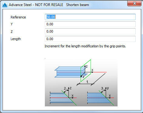

Shorten Beam Dialog
Use the parameters on this tab to modify the beam length or to create a diagonal cut.
Reference Defines the shortening (or lengthening) size. A positive value trims the beam and a negative value extends the beam.
Y Defines the rotation angle around the main Y-axis of the beam.
Z Defines the rotation angle around the main Z-axis of the beam.
Length Defines the length increment (grid jump) when modifying the shortening position using the grip points.
