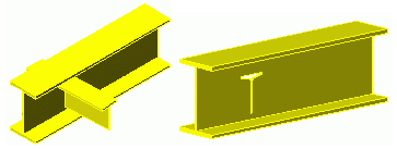

A straight or curved beam is processed through the geometry of another beam or plate. The object contour creates a cope at a straight or curved beam.

Process a beam with another element
  1. Features tool palette: (Element Contour, UCS).
  2. Select a beam to modify at a reference end.
  3. Select an object to use for the cut.
  • The contour processing is created.
