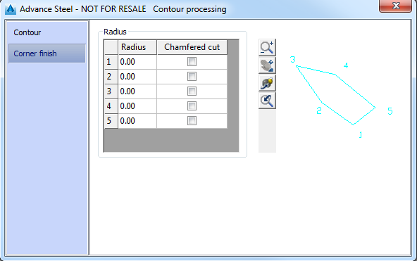

Polygonal Contour Processing Dialog - Corner Finish Tab
Use the table parameters to change the shape of each corner of the polygonal contour.
Radius Defines the radius of the corner finish.
Chamfered cut If enabled, creates a chamfered corner. Otherwise a filleted corner is created.
Preview area Displays a preview of the polygonal contour.
Zoom real time
The cursor changes to . Dragging the cursor up the preview area while pressing the mouse button enlarges the preview image. Dragging the cursor down the preview area reduces the size of the preview image.
Panoramic
Moves the object in the preview area.
3D orbit
Modifies the 3D objects view in the preview area.
Initial view
Restores the initial magnification and position
