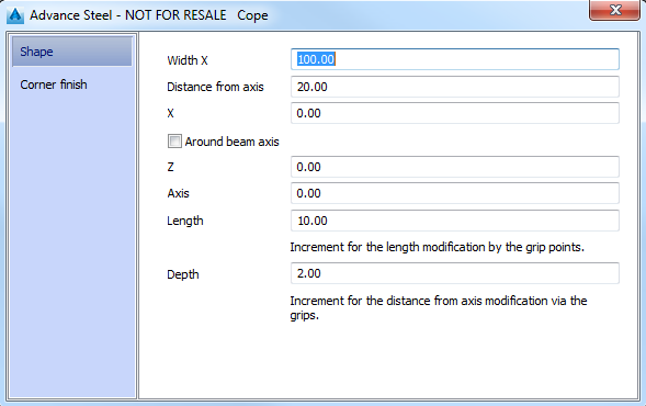

Skewed Cope Dialog: Shape Tab
You can use the parameters on this tab to modify the cope size.
Width X
Defines the cope width.
Distance from axis
Defines the cope corner distance to the beam axis.
X Defines the rotation angle around the X-axis of the coordinate system.
Around beam axis
Z Defines the rotation angle around the Z-axis of the coordinate system.
Axis Defines the rotation angle around the cope axis.
Length Defines the length increment (grid jump) when modifying the cope length using the grips.
Depth Defines the increment (grid jump) when modifying the distance from the axis using the grips.
