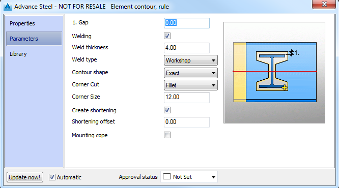

Use the table parameters to change the shape of the element contour.
1. Gap
Defines the distance between the beam and the contour.
Welding
Creates a weld between the two elements.
Weld thickness
Defines the weld thickness.
Weld type
Select the weld type from the list.
Contour shape
Select the method for cutting the beam: A rectangle representing the casing cross section of the penetrating element.
The exact cross section contour (the radii as straight intersections).
Casing cross section
Exact cross section
Corner cut
For an exact contour, select the shape of the contour corner:
Fillet: Creates filleted corners. The fillet size is modified by setting the radius in the Corner size field.
Chamfer: Creates chamfered corners. The fillet size is modified by setting the side length in the Corner size field.
Corner size
Defines the size of the corner.
Create shortening
Shortens or extends the processed beam.
Shortening offset
Adjusts the beam length.
Mounting cope
Creates a mounting cope.
