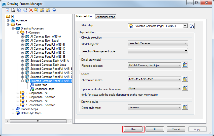

- Open the
Drawing Process Manager in the
Output tab >
Document Manager panel.

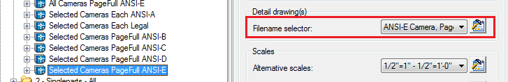

- Click the
button, next to the
Filename selector drop-down.

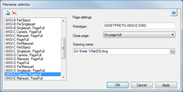

- In the
Filename selector dialog, you can see the used prototype and the Drawing name.
- Close the dialog.
- Click
Use in the
Drawing Process Manager window.

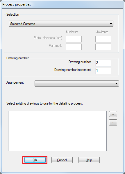

- Click
OK in the
Process properties window.

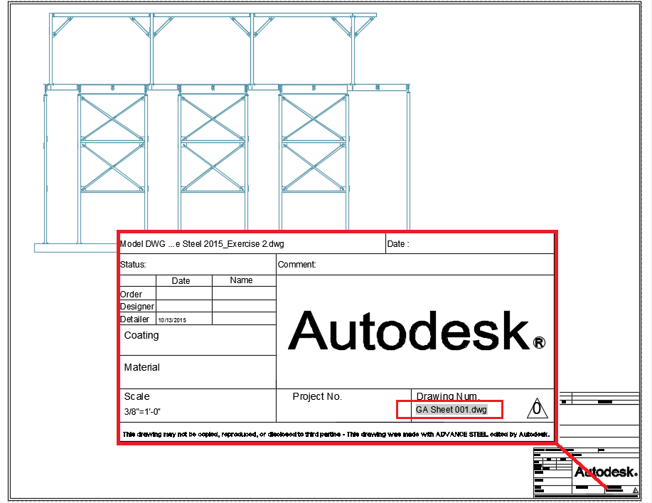

- Open the created detail drawing and see the result.
Create a detail drawing, using a process (e.g. Selected Cameras PageFull ANSIE-E).
