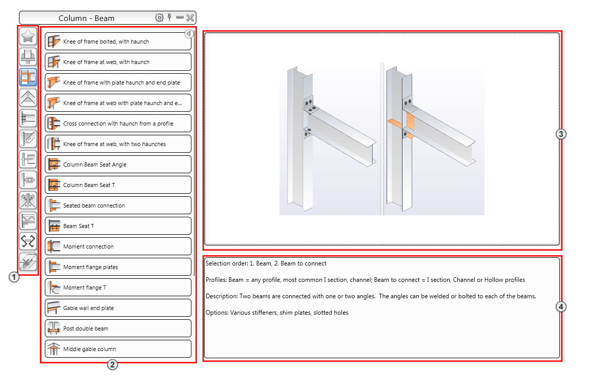

The Connection Vault Palette
Use the buttons on the left to display the connections grouped in a category. Moving the mouse cursor over a connection from the list displays a graphical representation of the selected connection and a short description.
You can resize, dock and anchor the Connection Vault. Like the Advance tool palette, you can control the rollover behavior and customize the appearance of the Connection Vault.
The connection categories. |
The list of connections included in the category. |
Connection preview - Graphical representation. |
Connection description. |
