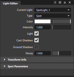

Light Editor
Lets you modify light parameters of the selected light as well as change the selected light's type.
Common Light parameters
Type
Lets you choose from the different light types. See Light Lister.

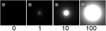

Intensity
The brightness of the light. If the light exerts a force, this value sets its strength. A light with an Intensity value of 0 produces no light. A light with negative Intensity value removes light from a scene in the area of the light’s influence. The slider range is 0 to 100. The default value is 1.
