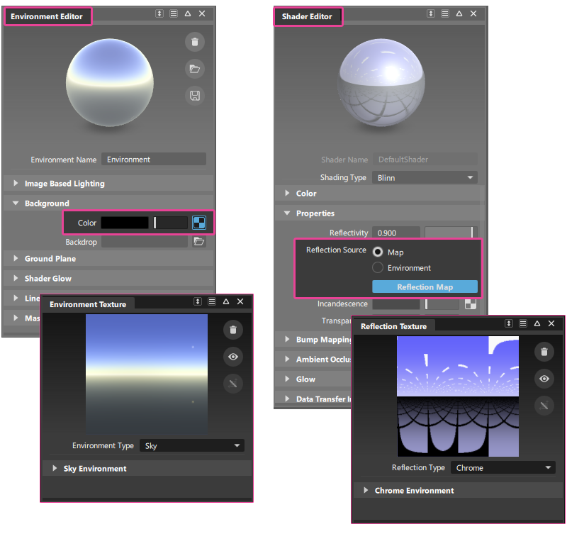

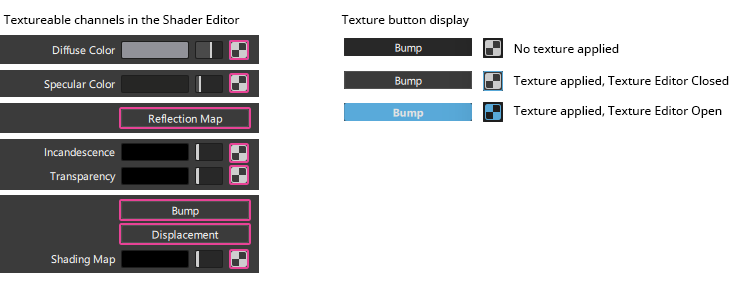

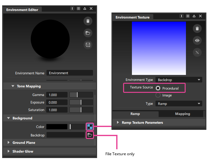

Texturable Channels in the Shader Editor
The Texture editor opens when a texturable channel in the Shader Editor or Environment Editor is selected.
The following channels in the Shader Editor can have textures mapped to them. Select the texture icon beside each channel to open the Texture Editor.
missing PNG
Channels, such as Bump, Displacement and reflection map, don't have a slider value, and so the buttons are full size.

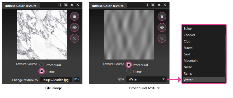

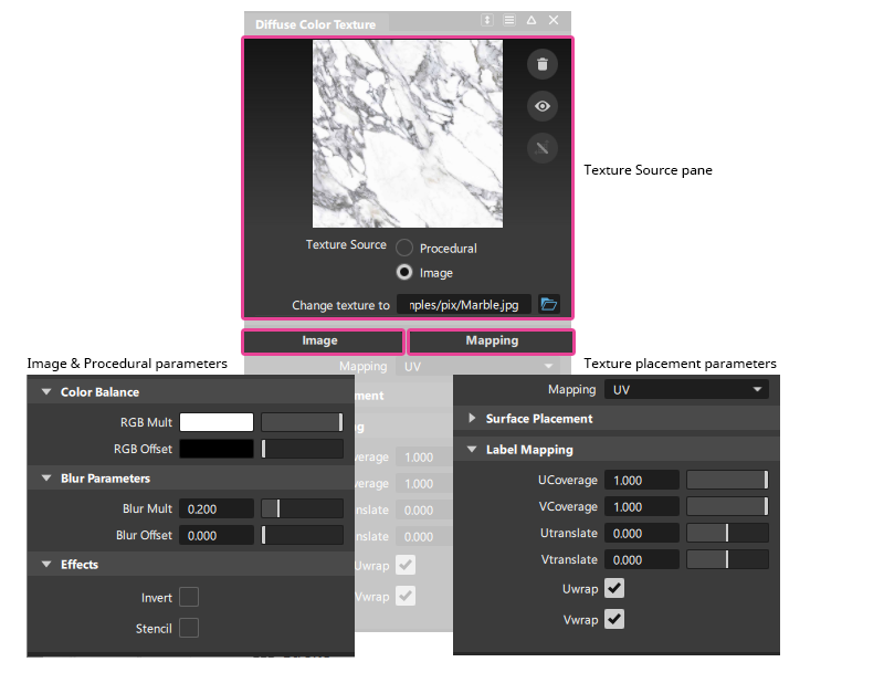

Texture Source pane
Texture icons
- Deletes the current texture.
- Toggles the texture on and off. Applies or removes the texture from the shader.
- Toggles the Projection Texture in-canvas manipulator on and off.
Texture Source
  • Image - Select an image file (.jpg, .png, .tif)
    Click Change texture to to browse and select an image.
  • Procedural - Select an procedural texture from the Type drop-down list. For details of each texture see the Procedural parameters section below.
Image: Common parameters
The image parameters appear in the Image tab in the Texture Editor:
missing PNG
Color Balance
The Color Balance parameters let you color correct a texture. These parameters are not available when the texture is mapped to certain single-channel parameters (for example, Reflectivity, Bump, Displacement). In these cases, the Color Balance parameters (Rgbmult and Rgboffset) are replaced by the Intensity parameters (Amult and Aoffset).
  • RGB Mult - A scaling factor applied to the parameter that the texture is mapped to. That is, all colors in the texture are multiplied by the Rgbmult color. For example, you can color correct a texture that appears too green by setting the Rgbmult color to a shade of blue.The default color is white (no effect).
  • RGB Offset - An offset factor applied to the parameter that the texture is mapped to. That is, all colors in the texture have the Rgboffset color added to them. For example, you can brighten a texture that appears too dark by setting the Rgboffset color to a shade of gray. The default color is black (no effect).

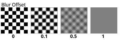

Blur
The Blur parameters control the sharpness of the texture. If the Blur parameter values are both 0, the texture is perfectly sharp. However, a small amount of blur is usually needed to reduce aliasing effects.
  • Blur Mult - Legacy setting that has no effect in Hardware Shade.
  • Blur Offset - An offset factor that controls the amount of texture blur in texture space. That is, the amount of blur is the same no matter where the object is relative to the camera. The slider range is 0 (no blur) to 1 (completely blurred). The default value is 0.
Effects
The Effects parameters apply to the texture image.

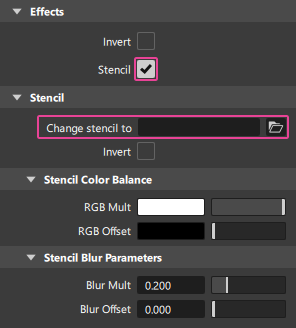

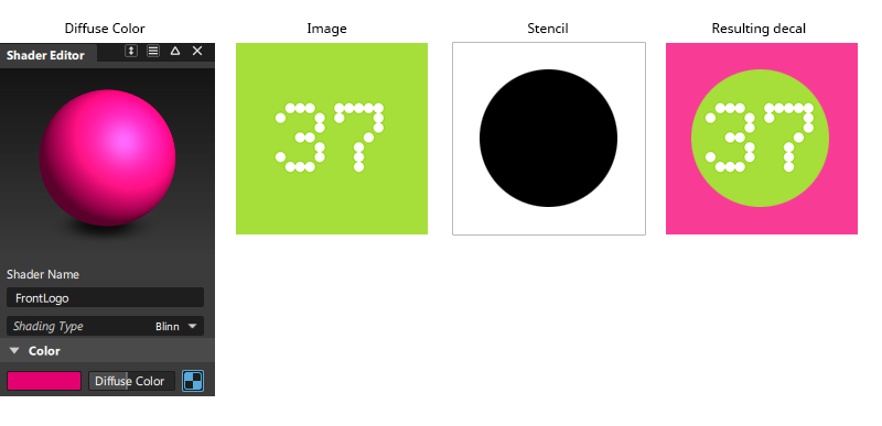

  • Invert - When you invert a black-and-white photo, the white pixels become black pixels and vice versa. But if you invert a color image, the resulting photo will have a flipped color scheme.
  • Stencil - Use a mask image to define the outline for a decal effect. The image is typically black and white, with white areas defining the parts of the image to ignore.
    Selecting Stencil opens the Stencil Parameters section:
    missing png
The Color Balance and Blur parameters are the same as for the main image (see above).

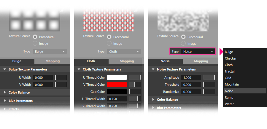

Image: Procedural parameters
The procedural image parameters appear in the Image tab in the Texture Editor. The parameters displayed vary with each Procedural Type:

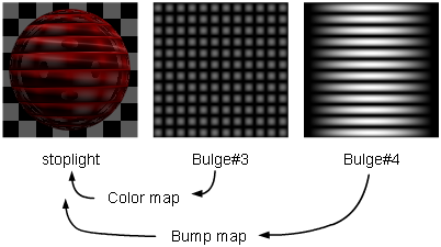

Bulge Texture Parameters
The Bulge texture represents a grid of white squares which fade to grey toward their edges. Use the Bulge texture as a bump or displacement map to create surface bulges, as a transparency map to simulate windows that are dirty around the edges, or as a color map to simulate tiles.
  • Uwidth, Vwidth - The width of the texture squares in the U and V parametric directions. The valid range is 0 to 1. The slider range is 0 to 0.5. The default value is 0.1.

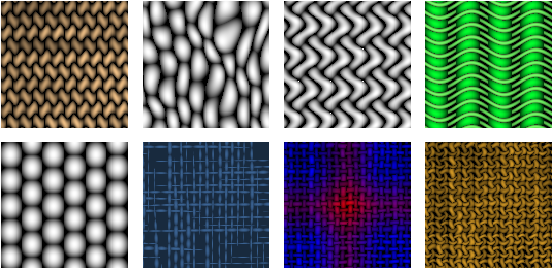

Cloth Texture Parameters
The Cloth texture simulates fabric or other woven materials.
  • U ThreadColor, V ThreadColor - The colors of the warp (U direction) and weft (V direction) threads of the cloth.
  • Gap Color - The color of the area between the warp and weft threads. The threads’ colors blend into the Gap Color at their edges, so a lighter Gap Color tends to simulate a cloth with softer, more translucent threads.
  • U Thread Width, V Thread Width - The width of the warp and weft threads. If the thread width is 1, then the threads will fully touch with no gap between them. If the thread width is 0, the thread will disappear. (You can randomize thread width by setting the Width Spread parameter.) The valid/slider range is 0 to 1. The default value is 0.75.
  • U Wave, V Wave - Controls the waviness of the warp and weft threads to create special weave effects such as herringbone. The slider range is 0 to 0.5. The default value is 0.
  • Randomness - Smears the texture randomly in the U and V directions. Adjust the Randomness value to create natural-looking cloth with irregular threads, or to prevent aliasing and moiré patterns on very fine cloth textures. The valid range is 0 to infinity. The slider range is 0 to 1. The default value is 0.
  • Width Spread - Randomizes the width of each thread along its length by subtracting a random amount (between 0 and the Width Spread value) from the U Thread Width and V Thread Width values. For example, if the thread widths are 1 and the Width Spread value is 0.75, the actual thread widths with vary between 0.25 and 1. If the Width Spread value is greater than or equal to the Thread Width value, then some threads will disappear entirely at certain points along their length. The valid/slider range is 0 to 1. The default value is 0.
  • Bright Spread - Randomizes the brightness of each thread along its length by subtracting a random amount (between 0 and the Bright Spread value) from U Thread Color and V Thread Color (similar to Width Spread). The valid/slider range is 0 to 1. The default value is 0.

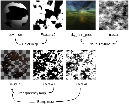

Fractal Texture Parameters
The Fractal texture represents a random function with a particular frequency distribution (a fractal) and can be used to create many different types of effects. Use the Fractal texture as a bump or displacement map to simulate rock or mountains, or as a transparency map to simulate clouds or flames. The Fractal texture has the same level of roughness at different levels of magnification (that is, at different distances from the camera).
  • Amplitude - A scaling factor applied to all values in the texture about the texture’s average value. The valid range is 0 to infinity. The slider range is 0 to 1. The default value is 1.
  • Threshold - An offset factor applied to all values in the texture. The valid range is 0 to infinity. The slider range is 0 to 1. The default value is 0.
  • Ratio - Controls the frequency of the fractal pattern. The valid/slider range is 0 (low frequency) to 1 (high frequency). The default value is 0.707.
  • Level Min, Level Max - The minimum and maximum number of iterations used to calculate the fractal pattern. These parameters control how fine grained the fractal pattern is. The valid range is 0 to 100. The slider range is 0 to 25. The default value is 0 for Level_min and 9 for Level_max.
    Tip: If both Level_min and Level_max are high (close to 100) rendering will take a long time. If you want to make the fractal pattern more finely grained, lower the Blurmult or Amult value instead.
  • Randomize - Randomizes cell position. The valid range is 0 to 1.

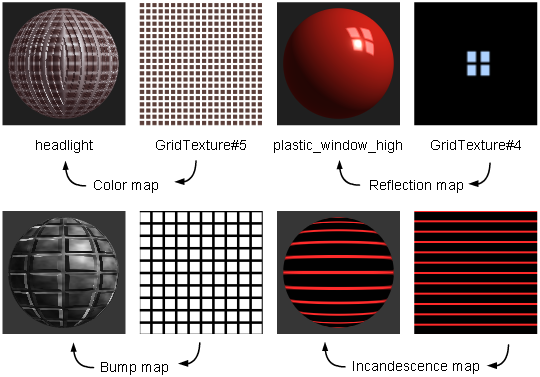

Grid Texture Parameters
The Grid texture represents a scalar grid pattern.
  • Line_color - The color of the grid lines. The default color is white.
  • Filler_color - The color of the spaces between the grid lines. The default color is black.
  • Uwidth, Vwidth - The width of the grid lines in the U and V parametric directions. The valid range is 0 to 1. The slider range is 0 to 0.5. The default value is 0.1.
  • Contrast - The contrast between the Line Color and the Filler Color. The valid/slider range is 0 (the two colors are averaged over the entire texture) to 1. The default value is 1.

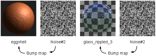

Noise Texture Parameters
The Noise texture represents a random pattern of two colors. The Noise texture appears smoother the closer it is to the camera.

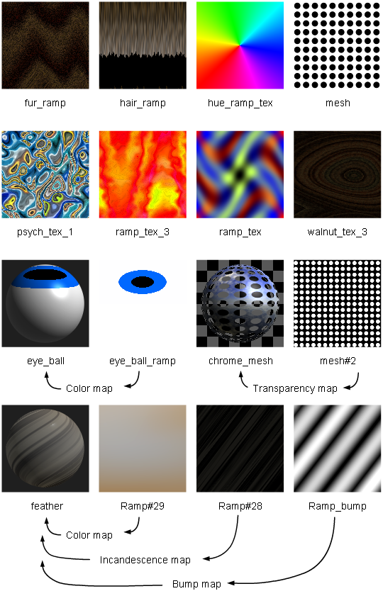

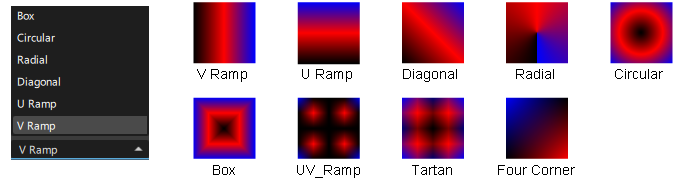

Ramp Texture Parameters
The Ramp texture represents a gradation through a series of colors. The ramp texture can be used to create many different types of effects (stripes, geometric patterns, mottled surfaces).
The default ramp texture is blue/red/black unless the texture is mapped to certain single-channel parameters (for example, Reflectivity, Bump, Displacement). In these cases the ramp is black/white/black.

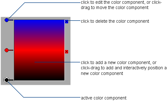

Ramp
Each color component in the ramp has a circular color handle on the left side of the ramp, and a square color icon on the right side of the ramp (except for the bottom color in the ramp). The active color has a white border around its color handle. The Position and Ramp Color parameters apply to the active color only. That is, to edit a color component’s Position value or Ramp Color, you must first click its color handle to make it the active color component.
Only changes in Ramp Type, Interpolation, Position, and Ramp Color are actually displayed in the ramp. Changes in all parameters are displayed in the Multi-lister swatch.
  • Ramp Type - Controls the direction of the color ramp. The default setting is V RAMP.
  • Interpolation - Controls the way colors in the ramp are blended. The default setting is LINEAR_RAMP.
  • Position - The position of the active color component in the ramp. The valid/slider range is 0 (bottom of ramp) to 1 (top of ramp).
  • Ramp Color, Intensity - The color or intensity of the active color component. Only one of these parameters (Ramp Color or Intensity) is available for a particular ramp texture. If the Ramp texture is mapped to a three-channel parameter (for example, Color), then the Ramp Color parameter is available. If the Ramp texture is mapped to a single-channel parameter (for example, Bump), then the Intensity parameter is available. The slider range for Intensity is 0 to 1.
  • U Wave, V Wave - Controls the amplitude of a sine wave offset of the texture in the U and V directions. Increasing the U Wave or V Wave value makes the texture appear increasingly wavy. The slider range is 0 (no wave) to 1. The default value is 0.
    Tip: To increase the number of waves in the texture, increase the Urepeat or Vrepeat values.

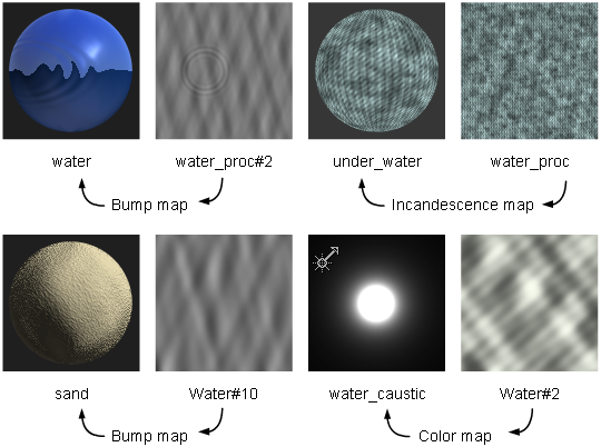

Water Texture Parameters
Linear Wave Parameters
The Linear Wave Parameters control the appearance of linear water waves. The Linear Wave Parameters do not affect the concentric ripple component of the texture.
  • Number Waves - The number of linear waves in the texture. To create water ripples with no linear waves, set the Number Waves value to 0. To combine linear waves with concentric ripples, set the Number Waves value to a low number (1 to 3). The valid range is 0 to 100. The slider range is 0 to 32. The default value is 8.
  • Wave Time - Controls the appearance of the waves over time. If you relate the wave effect to the wake from a boat, the waves start off at some point with a certain velocity and amplitude. This is time zero. As time increases, the waves travel to shore and their appearance changes (their velocity and amplitude decrease). The slider range is 0 to 1. The default value is 0.
    To simulate moving water waves, animate the Wave_time value. The waves will move as this value increases. The actual speed of the waves is determined by the Wave_velocity value and the rate at which you animate the Wave_time value.

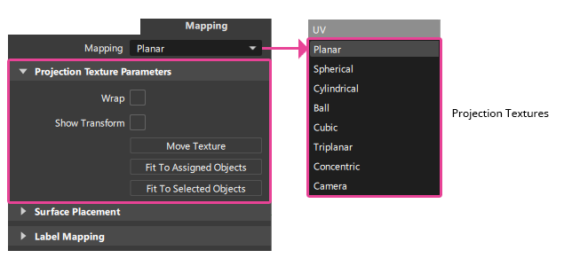

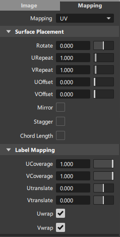

Mapping: UV Texture parameters

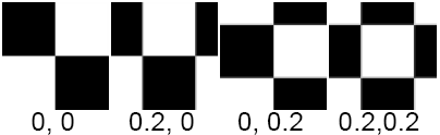

The UV image parameters appear in the Mapping tab in the Texture Editor when Mapping Type is set to UV:
Surface Placement
The Surface Placement parameters control how a texture’s pattern covers the texture coverage area (the area the texture covers on the actual surface).

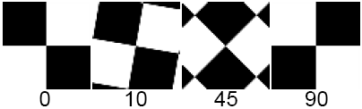

Rotate
The angle (in degrees) the texture map is rotated on the surface. The slider range is 0 to 360. The default value is 0 (no rotation).

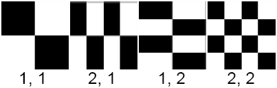

Urepeat, Vrepeat
The number of times the texture is repeated within the coverage area along the surface’s U and V parametric directions. If Urepeat value or Vrepeat value are greater than 1, the texture will be repeated several times within the coverage area, but the size of each instance of the texture will be smaller than the default size. Similarly, if the Urepeat value or the Vrepeat value are less than 1, only a portion of the texture will be mapped to the surface. The slider range is 1 to 10. The default value for most textures is 1.

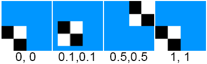

Uoffset, Voffset
Offsets the texture pattern (without actually moving the texture itself) along the surface’s U and V parametric directions. Adjust the Uoffset and Voffset values to fine-tune the placement of a pattern on a surface. The slider range is 0 (no offset) to 1. The default value is 0.
Mirror
Mirrors repeated patterns of the texture (when the Urepeat value or the Vrepeat value is greater than 1) so that rows of images appear as mirrored images of themselves. This helps to disguise the effect of seams between repeated areas. The default setting is OFF.
Stagger
Offsets repeated patterns of the texture (when the Urepeat value or the Vrepeat value is greater than 1) so that alternate rows are offset exactly half, like bricks in a brick wall. When Stagger is OFF, the repeated patterns line up horizontally and vertically. The default setting is OFF.
Chord Length
Causes the texture to use a mapping technique that ignores the UV parameterization of the (spline-based) surface, and instead maps according to surface distances (measured in world space units). This can help minimize texture distortion on surfaces with non-uniform parameterization. The default setting is OFF.
Label Mapping
The Label Mapping parameters control how the texture covers the surface.
Ucoverage, Vcoverage
The fraction of the surface covered by the texture along the surface’s U and V parametric directions. For example, if the Ucoverage and Vcoverage values are both 0.5, the texture will cover half of the surface in the U direction and half of the surface in the V direction, or one quarter of the total surface. Areas outside of the texture coverage area have a non-texture mapped parameter value as indicated in the shader’s Control Window (for example, the shader color). The slider range is 0 to 1. The default value is 1.
Utranslate, Vtranslate
Moves the texture coverage area along the surface’s U and V parametric directions. Effectively, the Utranslate and Vtranslate values determine where the texture map will be located on the surface. The slider range is 0 to 1. The default setting is 0.
Uwrap, Vwrap
Determines whether or not the texture will replicate (copy itself outside of the coverage area) in the surface’s U and V parametric directions, when the Utranslate or Vtranslate value is greater than 0.
By default, both Uwrap and Vwrap are ON. Toggle these parameters OFF to prevent seams from showing on a closed surface, such as a cylinder or sphere, or to prevent the texture from duplicating itself when you are using the translation and coverage parameters to limit the mapping to a very specific surface area.
Mapping: Projection Texture parameters
The Projection Texture parameters appear in the Mapping tab in the Texture Editor when one of the 3D solid projection mapping types is selected.
missing png
  • Wrap - Repeats the texture outside the region defined by the Texture Placement object. If Wrap is OFF, the texture only appears on a surface inside the region defined by the Texture Placement object. The default setting is ON.
  • Show Transform - Displays the texture placement object, so that it's position can be seen and it can be selected and transformed. By default, the Texture Placement Object for all textures is invisible.
    The Texture Placement Object will appear at the origin by default.
    If you cannot see the object, check that Textures are turned on in the viewport Show menu.
  • Move Texture - Selects the texture placement object and displays the Transform manipulator. Use Pick > Nothing to clear the manipulator display.
  • Fit to Assigned Object - Resizes the texture placement object to fit the geometry that the shader has been assigned to.
  • Fit to Selected Objects - Resizes the texture placement object to fit the selected geometry.

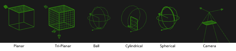

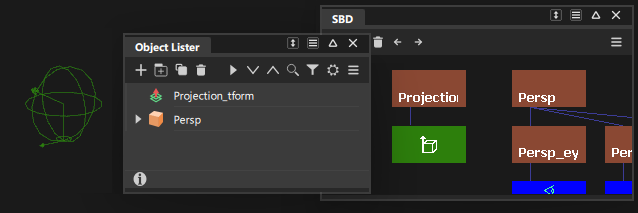

About Texture Placement Objects
The Projection texture converts a two-dimensional image into a three-dimensional texture by projecting it in one or several directions. This makes it appear seamless across surface boundaries as it doesn't use the UV mapping for placement or sizing.
The Texture Placement Object determines the origin position and direction of the texture and can be modified using standard selection and transform tools.
The Texture Placement Object for a Projection texture is different for each Projection type:
missing png
By default, the Texture Placement Object for any environment texture is positioned at the origin with its arrow pointing in either the positive Y direction (for Y-up scenes) or the positive Z direction (for Z-up scenes).
When the Texture Placement Object has a crosshatched face, that shows where the 2D image will be mapped.
The Texture Placement Object also appears in the Object Lister and the SBD window as a separate transformation node beneath the texture node.
Mapping: Environment Texture parameters
Environment textures can be mapped to either:
  • Environment Shader: Background > Color - to create a surrounding image for objects to reflect.
  • Shader Editor: Properties > Reflection Map - to use a specific image for only the assigned objects to appear to reflect.

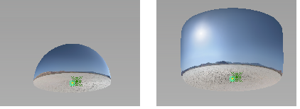

Geometric Environment Parameters
  • Geometry Type - The background image is mapped to either Dome Geometry or Cylinder Geometry depending on this setting. This geometry shape surrounds your model, but cannot be directly manipulated or rendered. You must use the Rotate, scale and height settings below to transform it.
  • Rotate - This slider rotates the environment geometry texture around the Up (vertical) axis.
  • Scale - This slider proportionally scales the environment geometry texture.
  • Height - This slider moves the environment geometry texture to a certain height above or below ground level (Z = 0). Clicking the Auto button automatically sets the base of the environment geometry to the bottom of the model's bounding box.

Texture mapping examples
Bulge
Fractal
Cloth
Grid
Mountain
Noise
Ramp
Water
