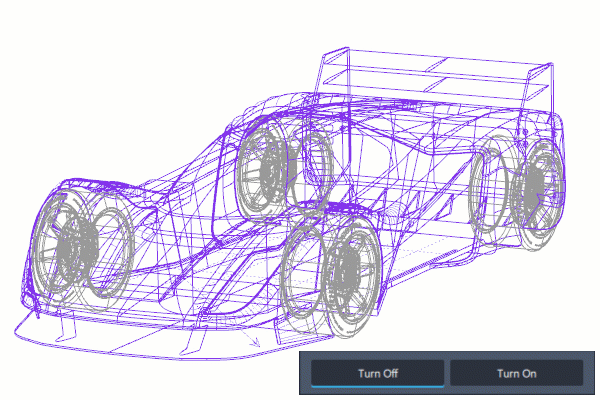

Hidden Line
Toggles between normal wireframe display and a display that simulates a hidden line drawing. Hidden line drawings hide portions of the model, such as edges that are obscured from view by other parts of the object closer to the camera.
It also draws contour lines around the silhouette of the object. This provides a view of the object, which reduces visual complexity. For example, it lets you see the shape without the distraction of internal edges and lines that regular wireframe displays.
Silhouettes of surfaces include the effect of any bump or displacement maps. Note that the silhouette is not calculated when moving the view, such as when tumbling.
