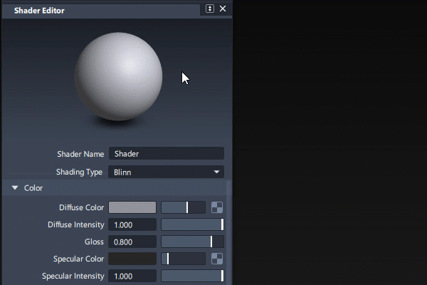

Shader Editor
Opens Shader Editor, which you use to edit shaders parameters and create textures.
A separate Texture Editor window opens when you map shader parameters to procedural or projected images (see Texture Parameters).
Shader name
The name of the shader. Shader swatches in the Shader Editor are listed alphabetically (except for the DefaultShader). If you change a shader’s name, the swatch display in the Shader Editor may also change.
Shading Type
Defines the basic surface type (for example, matte, reflective). The default setting is Lambert. Each Shading Model has its own set of Shading Parameters.
- Blinn - A metallic surface such as brass or aluminum.
- Phong - A glassy or glossy surface (ABS or SAN copolymer), which is often used for car mouldings, telephones, and bathroom fittings.
- Lambert - A matte surface, such as chalk, matte paint, or unpolished surface.
- Light Source - A special effect. Light falling on the surface is summed and averaged, and no complex shading is done. The surface does not act as a light meaning that it does not illuminate other objects.
The Shading Parameters differ between Lambert, Blinn, or Phong. There are no Shading Parameters when Shading Model is Light Source.

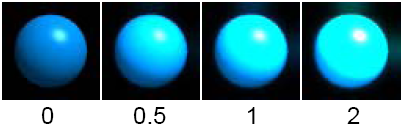

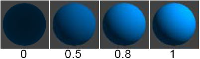

Diffuse Intensity
The ability of the surface to reflect light in all directions. The Diffuse value acts like a scaling factor applied to the Color setting: the higher the Diffuse value, the closer the actual surface color is to the Color setting. The valid range is 0 to infinity. The slider range is 0 (no light is reflected in all directions) to 1. The default color Value is 0.8.

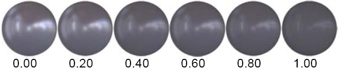

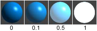

Gloss
Gloss reproduces the effect of surface shinyness. A high Gloss material has specular highlights the same color as its reflections. A low Gloss material has specular highlights the same color as its diffuse shading. Values in the middle blend between these.
Reflective materials with a low Gloss appearance could previously be achieved only with a layered shader.

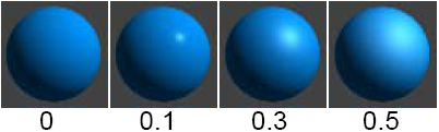

Specular Intensity
Specularity works with Gloss to determine the appearance of specular highlights that are based on the color of the bright parts of the environment cast on the object.
Specular reflections (the blurry ones), which in the past only reflected the light sources, such as point and directional lights, used to be colored only by Specular Color. Now they are colored by a blend of the Specular Color and the (diffuse) Color (which is actually the diffuse color of the surface), with the blending being controlled by Gloss. When Gloss is 1.0, it's pure “Specular Color”, when Gloss is 0.0 it's pure (diffuse) “Color.”
This is handy because it lets you do with one shader something that used to require a layered shader. It's also positively irreplacable with image based lighting (IBL), since even a layered shader wouldn't give you independent control over reflected and specular part of IBL.
Experiment with these two parameters together in Hardware shading to get new effects.
Low gloss and high specularity can produce a satiny, lustrous surface like a pearl or wood with an oiled or waxed finish. High gloss and low specularity gives small precise highlights, like highly polished enamel surfaces or wood with a varathane finish.

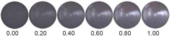

Specular Rolloff
The ability of the surface to reflect its surroundings (the environment, other surfaces), or the Reflection map, if any, when viewed at oblique angles. This parameter appears only when Shading Model is BLINN. To help visualize the effect of Spec. Rolloff in the shader swatch, temporarily assign a Reflection map to the shader.
The slider range is 0 to 1. The default value is 0.3.

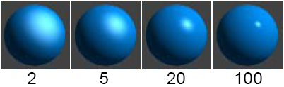

Shinyness
Controls the size of shiny highlights on the surface. This parameter is only available when Shading Model is PHONG. The valid range is 2 to infinity. The slider range is 2 (broad highlight, not very shiny surface) to 100 (small highlight, very shiny surface). The default value is 20.

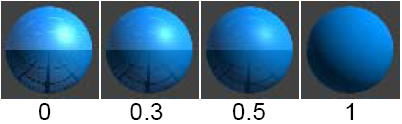

Eccentricity
Controls the size of shiny highlights on the surface. This parameter is only available when Shading Model is BLINN. The valid range is 0 (no highlight) to 0.999 (broad highlight, not very shiny surface). A value of 0.1 produces a small highlight (very shiny surface). The default value is 0.3.

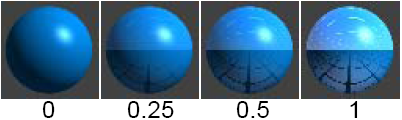

Reflectivity
The ability of the surface to reflect its surroundings (the environment, other surfaces), or the Reflection map, if any. Reflectivity values for common surface materials are: car paint (0.4), glass (0.7), mirror (1), chrome (1). To help visualize the effect of Reflectivity in the shader swatch, temporarily assign a Reflection map to the shader.
The valid range is 0 to infinity. The slider range is 0 (no reflections) to 1 (clear reflections). The default value is 0.5.

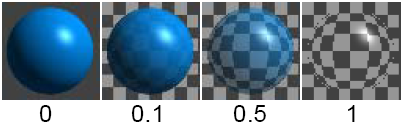

Transparency
The color and level of transparency of a surface. For example, if the Transparency Value is 0 (black), the surface is totally opaque; if the Transparency value is 1 (white), the surface is totally transparent. To make an object transparent, set the Transparency color to a shade of gray or to the same color as the shader Color. The default value is 0 (black).
If you change Transparency from the default black (0), the background of the shader’s Shader Editor swatch becomes a checkered pattern. This is a visual aid and is not rendered in your scene.

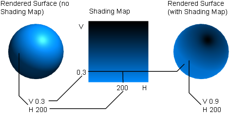

Shading Map
Applies a color map to the surface after it is rendered. The U value of the Shading Map texture is mapped to the surface’s hue, and the V value is mapped to the surface’s intensity (the value defined by [R+G+B]/3). A shading map changes the shader’s color, specular color, and eccentricity, effectively creating a new type of shading model.
A Shading Map is useful for creating non-photorealistic effects (for example, cartoon shading) or for highlighting threshold values (for example, using a ramp texture).
