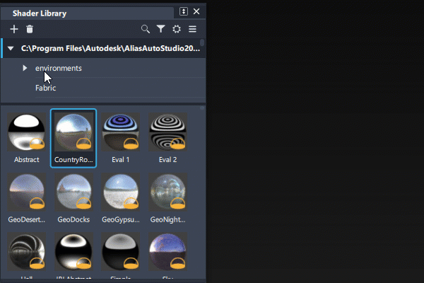

Shader Library
All shaders and environments that you can assign to objects are listed in the Shader Library. This includes libraries that you have installed on your system such the Autodesk Automotive Assets library.
Drag and drop any shader or environment into the Shader Lister, or into the scene.

Assign shaders from the Automotive Asset Library
The Automotive Assets Library (an application) installs with Alias Automotive Studio. The Automotive Asset Library provides common VRED materials that you can load into Alias as read-only approximations of the VRED materials. When you send a file to VRED, the Alias approximation is discarded and VRED uses the associated VRED material instead.
You can edit the common materials and create new customized versions of materials using Shader Lister and Shader Editor.
Access and use VRED materials in Alias
In the Shader Library, open the More menu, and then select Automotive Assets.
The Shader Library provides the path to the VRED materials.
Click the path to access the VRED materials in the library.
You can assign materials to models and surface from the Shader Library by LMB-drag a material. However, if you want to modify the material, you must drag it to the Shader Lister. See Shader Lister workflows.
To edit a common material from the Automotive Asset Library
LMB-drag a material into the Shader Lister.
Double-click the material swatch to open its parameters in the Shader Editor.
Update the material settings.
Assign the material to your models or surfaces using the same methods as Alias shaders.
