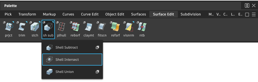

Keeps the intersecting volume of two shells and discard the rest.
Access this tool from the Surface Edit tool palette:
