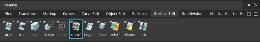

Access this tool from the Surface Edit tool palette :
