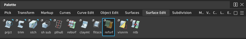

Access this tool from the Surface Edit tool palette :

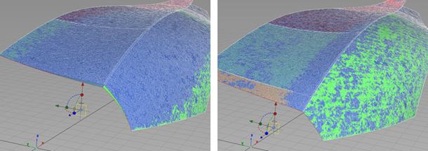

Deviation Check
Displays the maximum deviation between the surface and the mesh.
Deviation Scale
Sets the scale of the deviation combs.

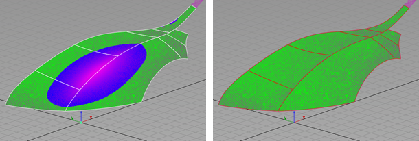

Refit Surfaces workflow
As part of the reverse engineering process, you can refit a selected set of surfaces to a scanned mesh. The refit surface set maintains the character of the original surface set (degree, spans, parameterization).
Before Refit left, After Refit right
Deviation Before Refit left, Deviation After Refit right
- Select the Refit Surfaces tool.
- Select the surfaces to refit and click Accept.
- Select the mesh to which you are refitting the surface.
- Adjust refit options, as needed.
- Click Build.
