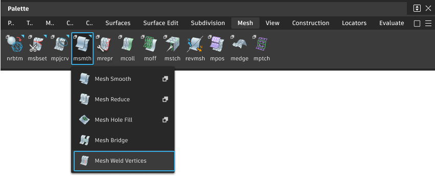

Access this tool from the Mesh tool palette:

Select the Mesh Weld Vertices tool
