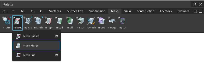

Access this tool from the Mesh tool palette:

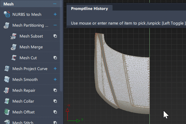

Merge meshes workflow
  1. Select the tool.
  2. Select two or more meshes.
  3. Press the Merge button in the lower right corner of the window.
    The selected meshes are combined into a single mesh object.
    Note: You can continue to select meshes then press Merge until you choose another continuous tool.
