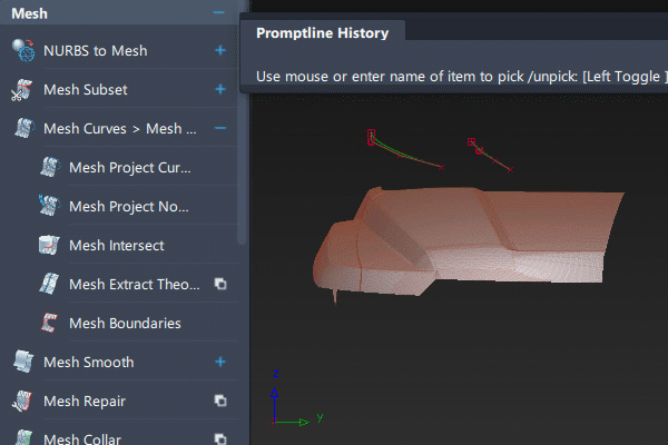

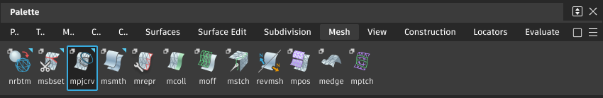

Access this tool from the Mesh tool palette:
Mesh Project Curves workflow
  1. Select the Mesh Project Curve tool.

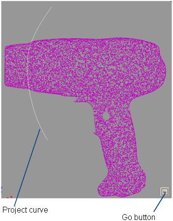

  3. Select:
    • the curve(s) you want to project, in the view window that is perpendicular to the projection direction OR
    • a projection vector, then the curve(s) you want to project.
  4. Press the Go button in the lower right hand corner.

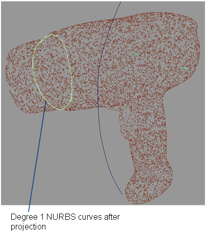

    Degree 1 NURBS curves are created on the mesh(es). They update if the input curve is modified.
    Note: These projected curves are often referred to as curves-on-mesh.
