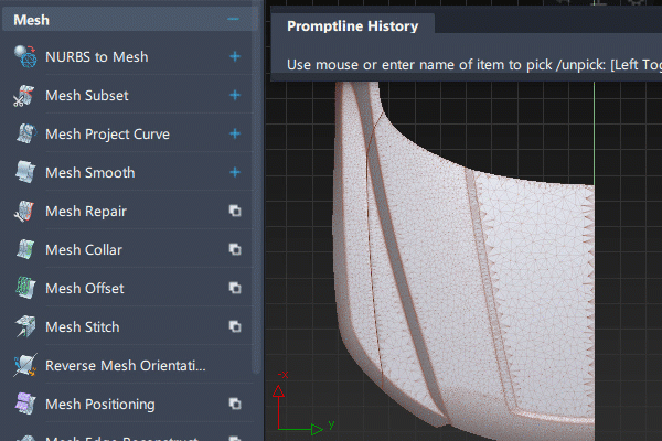

Selects portions of meshes and split them off as separate pieces. Subsetting a mesh allows you to delete or toggle invisible part of the mesh, or to shade the pieces independently, thereby increasing processing speed.

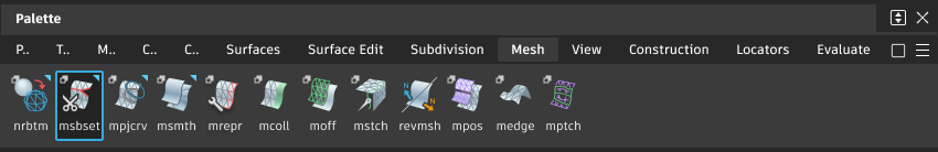

Access this tool from the Mesh tool palette:
Mesh Subset Control settings

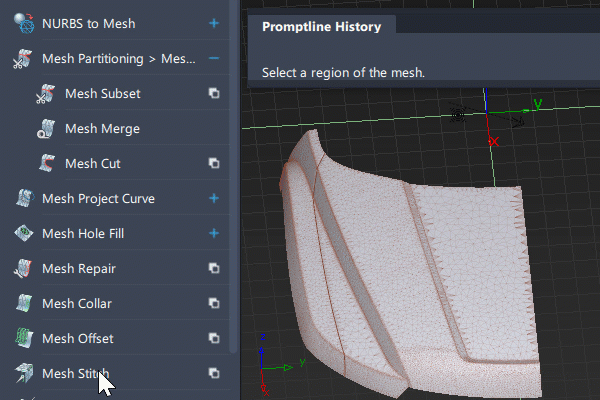

Mesh Subset workflow
Pick the mesh object.
Shift + click the Mesh Subset tool icon
.Select the mesh to subset.
