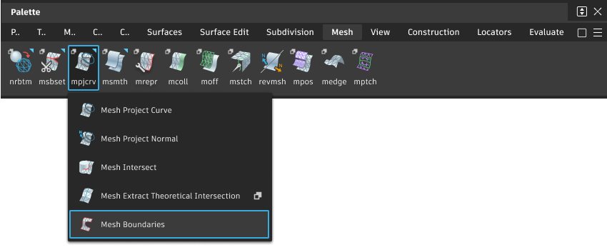

Creates degree 1 NURBS curves from selected mesh boundaries.
Access this tool from the Mesh tool palette:
Mesh Boundaries workflow
  1. Select the tool.

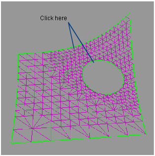

  2. Select a mesh.
    All the mesh boundaries are highlighted in green.
  3. Do one of the following:
    • Click on the boundary or boundaries you want to extract (they turn yellow), then press the Extract button at the bottom of the window.

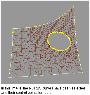

    • Press the Extract All button at the bottom of the window to extract all boundaries.
    One or more degree 1 NURBS curves are created and overlap the boundaries of the mesh.
