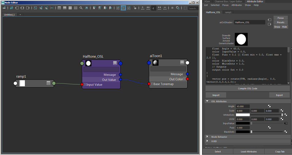

  • Assign a toon shader to your model.
  • Create an OSL shader and import/compile the Halftone OSL shader within it. Once it has compiled you should see the Halftone OSL attributes as values and sliders in the OSL shader.
  • Connect the OSL shader to the base tonemap attribute of the Toon shader.
  • You can control the halftone shading effect by connecting a black and white ramp (U/V) to the input value of the Halftone OSL shader.
Without ramp ramp -> Input Value of Halftone
