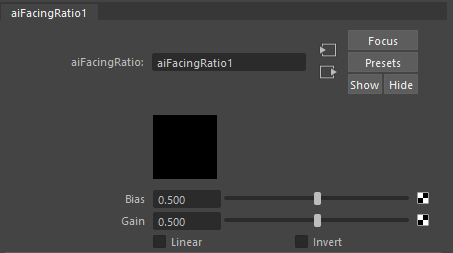

This shader returns the absolute value of the dot product between the shading normal and the incoming ray direction.

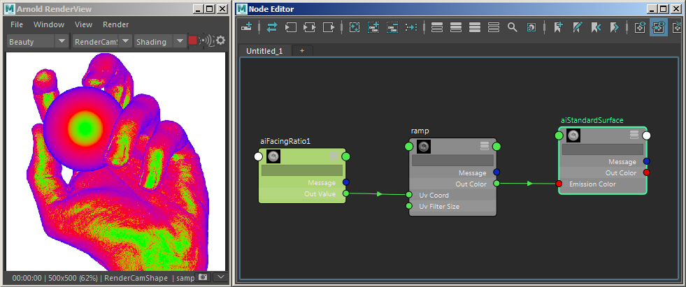

'Heat map' effect using a facing_ratio -> vcoord_ of ramp_rgb

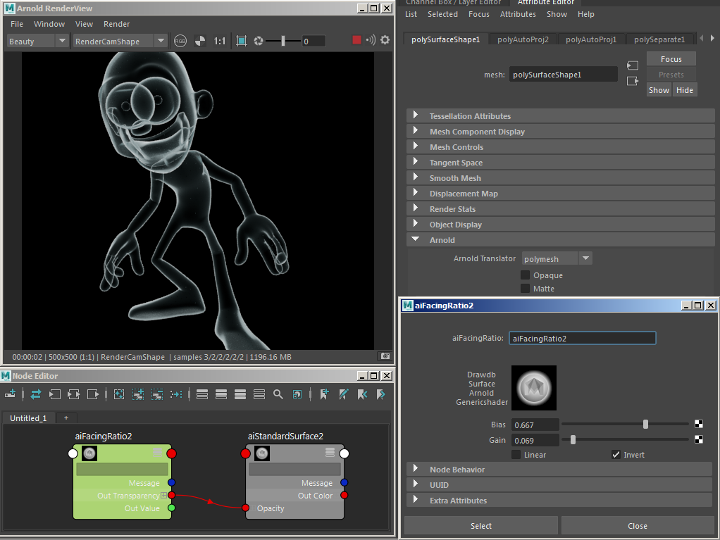

facing ratio -> opacity of standard_surface shader
Pepe model by Daniel M. Lara (Pepeland)
