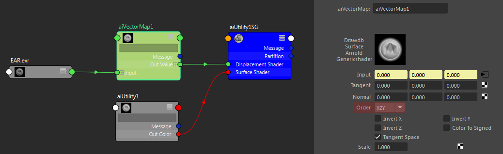

Vector Map connected to displacement shader (Order set to XZY)
