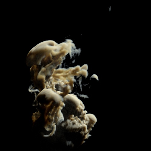

An object space offset to apply to the volume sampling position when using named channels to fetch the volume data. This is useful to displace the volume data.
You will need to connect a noise texture to the position offset to see any result.

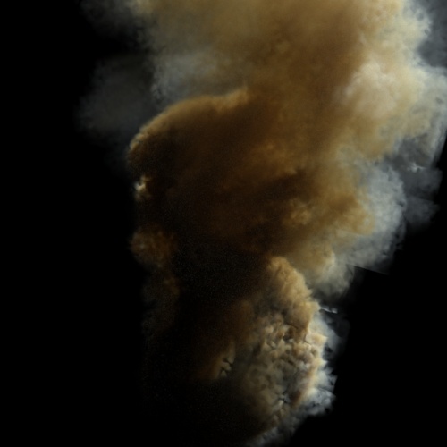

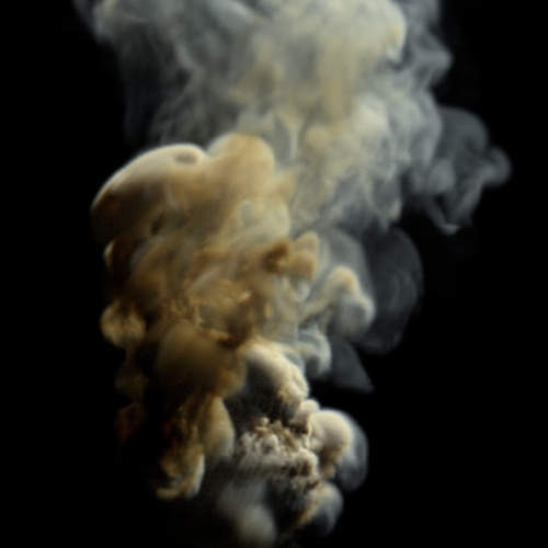

| -10 | -5 | 5 |

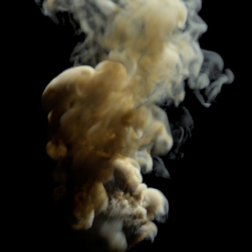

| tricubic | trilinear (default) | closest |

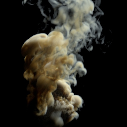

| 0.5 | 1 (default) | 3 |

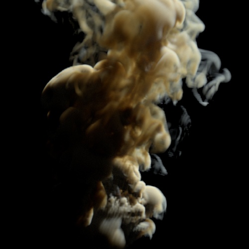

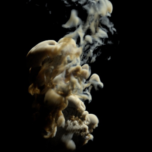

| 1 (default) | 1.5 | 3 |

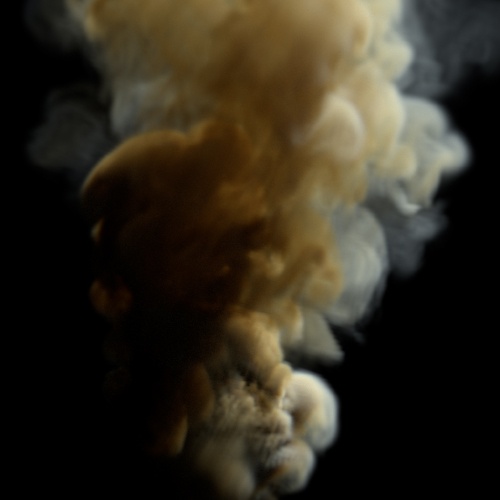

| 0.18 (default) | 0.5 | 1 |

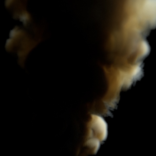

contrast: 3

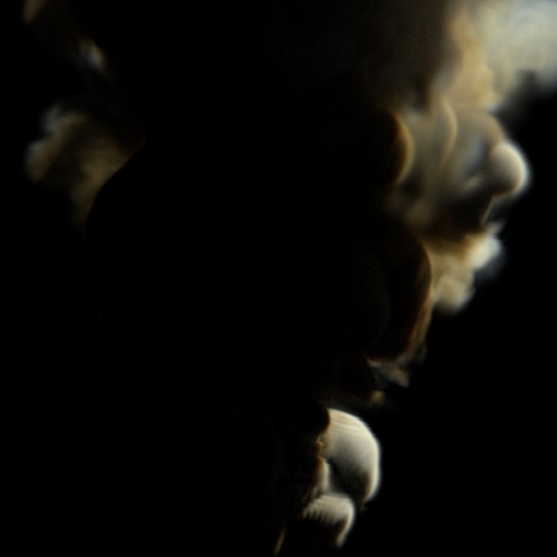

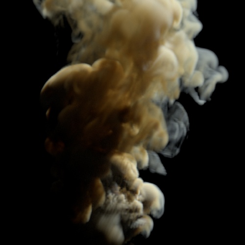

| 5 | 0 (default) | -5 |

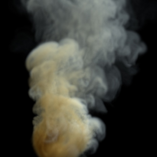

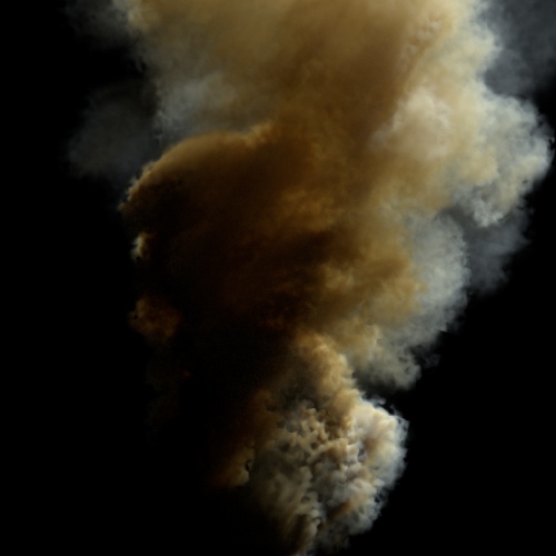

| 0.1 | 1 (default) | 5 |
