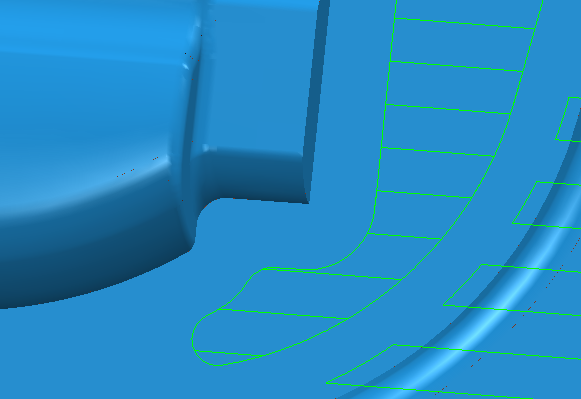

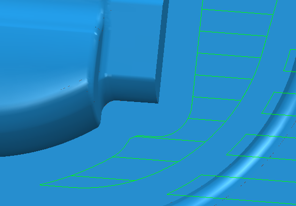

Profile smoothing — Select to allow the arc fitting of profiles to avoid sharp changes of direction in internal corners.
If you select the Profile smoothing option, the Radius (tool diameter units) field becomes available. The radius is defined as a proportion of the tool diameter. The default value is 0.05. So, if you have a tool of diameter 10 mm (radius 5 mm) then the arc radius will be 0.5 mm.
With a Radius of 0.2:
With Profile smoothing deselected:
