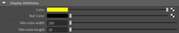

Display Attributes of a Sticky Notes
| Color | Color of the Sticky Notes in the Golaem Channel Operator Editor. |
| Text Color | Color of text of the Sticky Notes in the Golaem Channel Operator Editor. |
| Min note width | Minimum width size of the note in the Golaem Channel Operator Editor. The width will also be increased by the text's length. |
| Min note height | Minimum height size of the note in the Golaem Channel Operator Editor. The height will also be increased by the text's length. |
