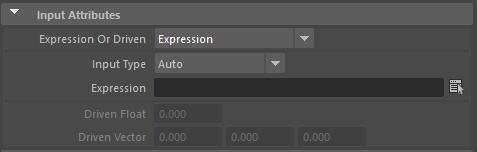

A Channel Operator Input defines the following specific attributes (accessible through the Maya Attribute Editor). For common attributes see Channel Operator Common Attributes.
Input Attributes
| Expression Or Driven | Indicates if this chOpInput uses an expression, a driven float or a driven vector attribute. |
| Input Type | The Operand part of an Expression which returns the value. It can be any of the following :
It is advised to use the combo-box to explicitly state the type of the Operand, otherwise Golaem will try to automatically determine it (but may fail sometimes). |
| Expression | The Operand part of an Expression which returns the value. Please check out the Expression help page for a more detailed help (beware that expression operators won't work here, only operands). |

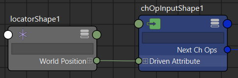

| Driven Float | When the Expression is left empty or set to Float, this is the value that is used for this Channel Operator. It can be filled manually or connected to any other Maya object to automatically get its value. ![]() |
| Driven Vector | When the Expression is left empty or set to Vector, this is the value that is used for this Channel Operator. It can be filled manually or connected to any other Maya object to automatically get its value (see example connection above) |
Ramp Attributes
| Ramp | Crowd Ramps which can be
used to feed Expressions. |
Advanced Attributes
| Execute At Frame Start | If the Expression is of type MEL or Python, specify if the script code should be run before or after the Golaem Simulation Step. |
