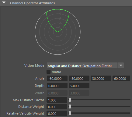

| Vision mode | Defines what will be extracted from the Sensor Locators. Available values are:
| !Ratio | In Angular Occupation / Distance Occupation / Angular and Distance Occupation / Spherical Occupation modes, this option will change the output value to 1-(occupied ratio), which means it will be 1 when the vision is empty, and 0 when it's full rather than the opposite |
| Angle | These parameters configure the zone in which checking for obstacles in the vision (represented as green zones in the Visual Feedback).
| Depth | |
| Width | |
| Max Distance Factor | Factor which will be multiplied by the greatest Depth or Width value to define the maximum distance at which computing the vision |

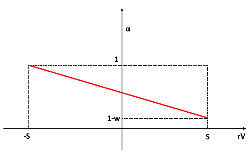

| Distance Weight | Allows the vision pixels to have a value between 0 and 1 according
to the distance to the perceived obstacle - entities that are farther
away are less taken into account, as in the figure below - w is the
distance weight, alpha (α) is the pixel value, Dmin and Dmax are the
values in the Depth paramete. ![]() The Distance Weight is between 0 and 1. At 0 the distance is not taken into account and the pixels have the same alpha. |

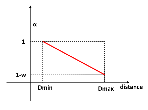

| Relative Velocity Weight | This weight takes into account the velocity of the perceived object
relative to the entity. This is projected along the front axis. The
relative velocity is negative when the objects are seen as coming
towards the entity and positive if the objects are seen as going away
from the entity. In the figure below, rV is the relative velocity, S is
the sum of the speeds of the entity and the perceived object and w the
Relative Velocity Weight. The more the perceived object goes the same
way as the entity, the lower its pixel alpha value. This allows lower
the importance of objects that go in the same direction or away from the
entity because there is no need to avoid them. If the Relative Velocity
Weight is 0 the relative velocity is not taken into account and the
pixels have the same alpha. The weight can be greater than 1, for
example at a value of 2 the alpha will be 0 when rV is 0, which means
that when a perceived object goes the same way and at the same speed or
faster than the entity it will be invisible (thus not avoided).![]() |

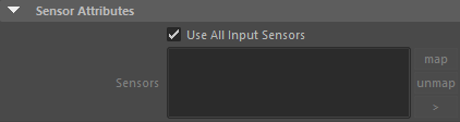

| Use All Input Sensors | Check to use all the available input sensor (ie. currently started by an Activate Sensor Behavior) on the Entity |
| Sensors | If "Use All Input Sensors" is not checked, this list lets you determine which Sensor Locators to use. Note that any Sensor listed here should also be enabled using the Activate Sensor Behavior to be effectively used. |
