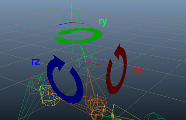

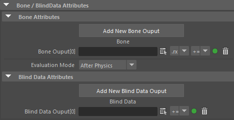

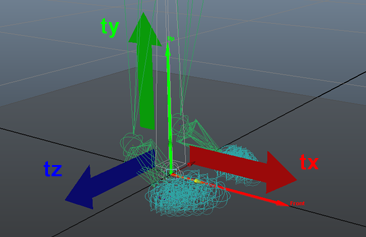

Bone Attributes
Bone
Name of a bone, transformation (t for world translation, l for local translation, r for local rotation, R for world rotations and s for scale) and bone component (x, y, z or all of them) which will be edited. Click on the helper button to check which Bones are available for the loaded Character File. The bone components and the local bone axis coordinate are visible when opening the Character File in the Character Maker:
  • When using the translation  or rotation transformation, any bone of the Character can be edited
  • When using the scale transformation, only bones with no child bone can be edited
When editing rotation using operators += and -=, the result of the expression code is evaluated as degree angles. When using *= and /=, the result of the expression code is evaluated as a multiplier / divider of the current orientation.
Use the "Add New Bone Expression" button and the trash icon to add or remove expressions.
Operator
The available operators are: =, +=, -=, *=, /=
Use the  icon to enable / disable an Expression without removing it from the behavior.
Blind Data Expression Attributes
Blind Data
Name of a Blind Data or a Blend Shape (i.e. or blindDataNode.blindDataAttribute blendShapeGroupName.blendShapeName) which value will be edited. Click on the helper button to check which Blind Data / Blend Shapes are available for the loaded Character File.
Use the "Add New Blend Shape Expression" button and the trash icon to add or remove expressions.
Operator
