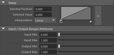

The Channel Operator Accu lets you remap the previous Channel Operators (ChOps) value within a Ramp.
A Channel Operator Ramp seen in the Channel Operator Editor (left) and in the Maya Node Editor (right)

A Channel Operator Ramp defines the following specific attributes. For common attributes see Channel Operator Common Attributes.
Channel Operator Attributes
| Ramp | Ramp curve used to remap the value of the previous Channel Operator. The scale of the two axis are defined by the range below |
| Input Min/Max | Input range of the ramp. If a second and a third Channel Operator nodes are connected to this node as an input, these attributes gets overwritten by its output value. |
| Output Min/Max | Output range of the ramp. If a fourth and a fifth Channel Operator nodes are connected to this node as an input, these attributes gets overwritten by its output value. |
