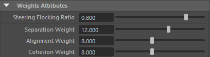

Weights Attributes
The weight attributes determine the global look of a flock (swarming, flock, etc).
Steering Flocking Ratio
If 0, the boid will only use its steering value, ignoring flocking behavior with other boids.
If 1, the boid will form a flock but will ignore the steering force of any Steer Behavior.
Any value between those 2 values will blend the two forces, default to 0.8 (a little of steering, mainly flocking).
Separation Weight Weight given to the separation force from the neighbor boids. Higher values lead to a bigger flocking volume
Alignment Weight Weight given to the alignment force : with high values, the boids will tend to align strongly in a single flow. With low values, the flock will behave more as a bees swarm, going in all directions.
Cohesion Weight Weight given to the cohesion force : with low values, you will have numerous small boid groups. With high values, the boids will behave more as a "single packed" entity.

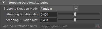

Stopping Duration Attributes
The Stopping Duration value determines the time (in seconds) during which the flock goes from fully active to inactive. This time can be used to transition smoothly between two behaviors.
Stopping Duration Mode
This attribute allows a choice of two modes :
  • Random: Randomly set the Stopping Duration value between the specified "Stopping Duration Min" and "Stopping Duration Max" bounds (this attribute is influenced by the random seed of the Crowd Manager)
  • Per-Particle Attribute: Use the "Stopping Duration Name" attribute to get the name of the float per-particle field of the relative particle system.
The Stopping Duration value is in seconds.
Stopping Duration Min See Random option of the Stopping Duration Mode above
Available only when the Stopping Duration Mode is set to "Random"
Stopping Duration Max See Random option of the Stopping Duration Mode above
Stopping Duration pp Name Name of the float per-particle field of the relative particle system, containing the Stopping Duration Mode value which will be used (for more explanation about how to use ppAttributes, see ppAttributes Handling)
Boid Max Force value is chosen randomly if the ppAttribute name is empty or invalid
Available only when the Stopping Duration Mode is set to "Per-Particle Attribute"
