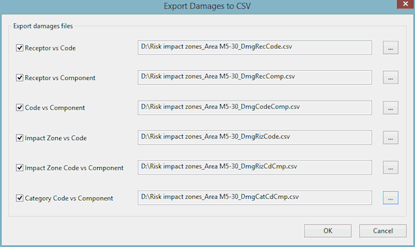

Export Damages to CSV Dialog
This dialog is used to export damage calculation results from Risk Analysis Simulations to CSV format.
It is displayed when you right-click a Risk Analysis Simulation and select Exportto CSV from the context menu.
Dialog description
Item Description
Receptor vs Code If checked, exports the table of damage values tabulated by Damage Receptor ID against damage function code.
Receptor vs Component If checked, exports the table of damage values tabulated by Damage Receptor ID against damage function component.
Code vs Component If checked, exports the table of damage values tabulated by damage function code against damage function component.
Impact Zone vs Code If checked, exports damage values per risk impact zone category tabulated by risk impact zone ID against damage function code.
Impact Zone Code vs Component If checked, exports damage values per risk impact zone tabulated by damage function code against damage function component.
Category Code vs Component If checked, exports damage values per risk impact zone category tabulated by damage function code against damage function component.
Browses for a location to save the exported CSV files to.
OK Exports the selected files, in CSV format, to the chosen locations.
Cancel Cancels the export operation.
