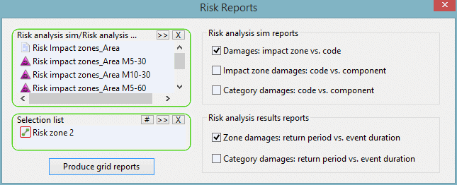

This dialog is used to generate grid reports from one or more Risk Analysis Runs, for a selection of Risk Impact Zones.
It is displayed when Risk report is selected from the Results menu.
Risk Report Dialog
Dialog description
Option
Description
Risk analysis sim/results
The names of the risk analysis simulations or results objects from which reports are to be generated. These can be selected by:
  • Dragging and dropping one or more simulation results from the database tree into the selection box.
  • Browsing for simulation items using the button.
If you select a parent risk analysis run object, all of its child risk analysis simulations and results objects will be loaded.
Selection list
A selection list can be used to restrict export of results to a selection of Risk Impact Zones. If a selection list is not included, the results of all impact zones will be exported.
A selection list can be included bys:
  • Dragging and dropping a selection list from the database tree into the Selection list box.
  • Browsing for a selection list using the button.
  • Clicking to include the objects currently selected on the GeoPlan View.
Risk analysis sim reports
Enabled when at least one risk analysis simulation object has been selected in the Risk analysis sim/results box.
Used to select which reports are to be generated:
  • Damages: impact zone vs. code - displays a grid view containing a tab for each risk impact zone category. Damage values per risk impact zone category are tabulated by risk impact zone ID against damage function code.
  • Impact zone damages: code vs. component - displays a grid view containing a tab for each risk impact zone. Damage values per risk impact zone are tabulated by damage function code against damage function component.
  • Category damages: code vs. component - displays a grid view containing a tab for each risk impact zone category. Damage values per risk impact zone category are tabulated by damage function code against damage function component.
See Risk Impact Zones for further details.
Risk analysis results reports
Enabled when at least one risk analysis results object has been selected in the Risk analysis sim/results box.
  • Zone damages: return period vs. event duration - displays a grid view containing a tab for each risk impact zone. Damage values per risk impact zone are tabulated by return period against event duration.
  • Category damages: return period vs. event duration - displays a grid view containing a tab for each risk impact zone category. Damage values per risk impact zone category are tabulated by return period against event duration.
Produce grid reports
Enabled when at least one report check box is enabled and ticked.
Displays a grid view of selected reports.
