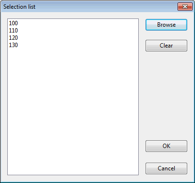

This dialog is displayed when you click
in the Target selection list A field for an
alert definition list.
It lets you specify a selection list of network objects to be included in Target A for the currently opened alert definition list.
Dialog description
Option |
Description |
Object list |
Initially blank, this box will list all the objects that are contained in the selected selection list. |
Browse |
Browse the current database for a selection list containing the objects of interest. Displays the Common Tree Selection dialog where a selection list can be selected. Note: If the chosen selection list contains objects of a different type to the one defined for the alert definition, these will be filtered out and will not appear in the Object list.
Clear |
Clears the object list on the left side of the dialog. |
OK |
Commits the changes and close the dialog. |
Cancel |
Aborts the process and close the dialog. |
