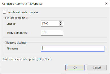

This dialog is displayed when you:
- Click Auto update in the Spatial Time Series Data Configuration dialog, or
- Select the Automatic update configuration in the Open TSD view as dialog
It is used to configure Spatial time series data objects for automatic update.
Dialog description
| Option | Description |
Disable automatic updates |
Indicator specifying whether or not automatic updates are to be performed on the data source. See Updating Time Series Data for further details. |
Schedules updates |
Start at - Time of day when the first update is to occur. This is expressed in the following format hh:mm (hh in 24 hour format). Note: This parameter is relative to the local time of the local server where the Data Loader is running.
Interval (minutes) - Amount of time, in minutes, that must elapse before performing the next update. |
Triggered updates |
File name - Absolute path and name of the file whose modification will trigger an automatic update. |
Last time series data update (UTC): |
Read-only.
UTC time that the data source was last updated. This field is automatically revised by InfoWorks ICM whenever an automatic or a manual update of the data source is carried out. |
OK |
Commit the changes and close the dialog. |
Cancel |
Abort the update and close the dialog. |
