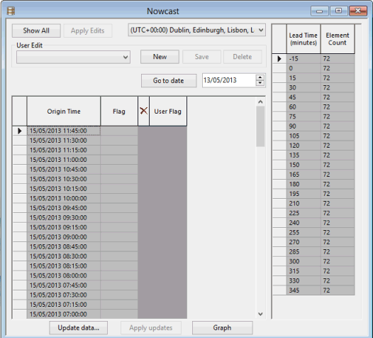

An example of a configured spatial TSD
For an in-depth description of the data and options available for this object, see the Time Series Data Grid topic.

  5. The Time Series Data grid is displayed.

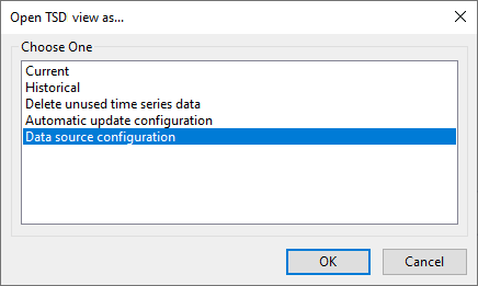

To open the Data Source configuration setting for a Spatial TSD object
  1. Right-click a Spatial TSD object in the Explorer Window and select Open As from the context menu.
  2. Select the Data source configuration option from the Open TSD view as dialog.
  3. Open TSD view as dialog
  4. Click OK.
  5. The Spatial time series data configuration dialog is displayed.

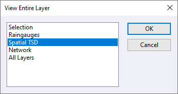

Zoom to a Spatial TSD on the network
To zoom to a Spatial TSD on a network that is currently open on the GeoPlan:
  1. Ensure that the relevant network is opened on the GeoPlan.
  2. Drag a Spatial TSD object from the Explorer window and drop it on the network in the GeoPlan.
  3. Right-click on the GeoPlan and select View entire GIS layer from the context menu.
    A View Entire Layer dialog, similar to the one shown below, is displayed:
    List of layers dialog
  4. Select the Spatial TSD option from the list.
  5. Click OK. The dialog closes and the GeoPlan zooms in on the applicable area of the network.
