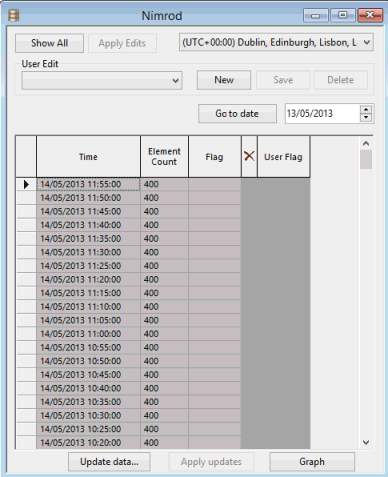

Example of Scalar time series data grid (observed data)
Example of Spatial time series data grid (forecast)

Grid description
The Time Series Data grid shows the time series data points for an individual stream. Latest values are displayed at the top.
The layout of the grid depends on the data type (observed or forecast).
The table below summarises the fields and options common to both types:
