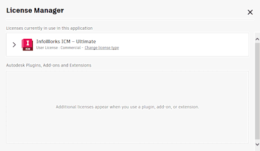

- Manage Licence - opens the
Autodesk Licence Manager window, which can be used to manage your
Autodesk licence.
Licence information is displayed by clicking >.
Clicking the Change licence type link displays the Autodesk Let's Get Started window, which you can use to switch Autodesk accounts.

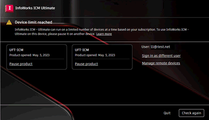

Subscription overuse
Based on your subscription, InfoWorks ICM licences may only be used on limited number of devices at any one time. When this limit is reached and you try to use the software on another device, a Device Limit Reached dialog is displayed. It lists the devices the software is currently being used on and lets you pause the usage on a selected device so that you can use the licence to access the software on the current device. An example is shown below.
- Pause product - Pauses the use of the licence and software on the selected device. You can now use the ICM on the current device.
- Sign in as another user - Displays the Autodesk Let's Get Started dialog. If you have access to another licence, you can sign in using it.
- Manage remote devices - Opens the Autodesk account compromise suspected page.
- Check again - Checks if the device licence limit is still at the maximum. If it is, the dialog is redisplayed. If not, you will be able to work with ICM on the current device.
- Quit - Closes ICM on the current device.
