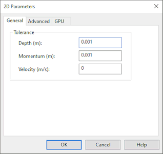

This dialog is used to view and edit tolerance parameters and advanced parameters for use in 2D simulations, and is displayed when you click the 2D Parameters button on the Schedule Hydraulic Run View (SWMM).
The items included in each tab are described in the following sections.
General
Parameter |
Description |
Depth |
Depth threshold used to determine whether to consider a mesh element wet or dry. Mesh elements with depth of water below this value will be considered dry and a zero depth will be displayed in the results. Only mass conservation will be considered in elements with depth below this threshold. Typical value: 0.001 m Default value: 0.001 m |
Momentum |
Depth threshold used to determine whether to consider momentum in a mesh element or not. Movement of water will not be calculated for mesh elements with depth of water below this value; only mass conservation will be taken into account. Typical value: 0.001-0.01 m Default value: 0.001 m |
Velocity |
Velocity threshold. Mesh elements with water velocity below this value will have velocity reset to zero in terms of momentum calculations. Typical value: 0 m/s Default value: 0 m/s |
