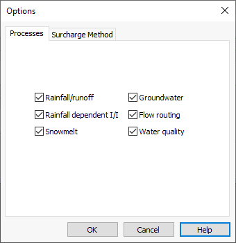

This dialog is used to set up the processing options and surcharge methods which are to be used for a SWMM run. It is displayed when you click Options in the SWMM Schedule Hydraulic Run View.
Processes Page
| Rainfall/runoff |
A check in the box indicates that the rainfall/ routing process is to be simulated. Checked by default. |
| Rainfall dependent I/I |
A check in the box indicates that rainfall dependent infiltration / inflows are to be simulated. Checked by default. |
Snowmelt |
A check in the box indicates that snowmelt is to be simulated. Checked by default. |
| Groundwater |
A check in the box indicates that any percolation of infiltrated water into groundwater layers are to be simulated. Checked by default. |
| Flow routing | A check in the box indicates that flow routing is to be simulated. Checked by default. |
| Water quality | A check in the box indicates that water quality is to be simulated. Checked by default. |
