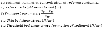

Sediment volumetric concentration ca:
where:

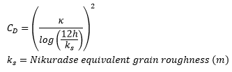

Logarithmic
Nikuradse

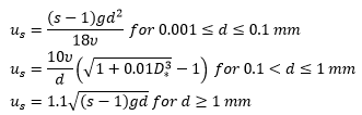

Van Rijn
Soulsby

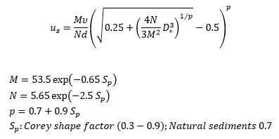

Wu and Wang
