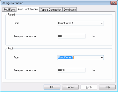

The number of paved connections is calculated assuming one connection per 300 m2 of connected paved area. The number of roof connections is calculated assuming one connection per 80 m2 of connected roof area. Both these assumptions can be defined on the Area Contribution Page. Therefore in this example there are 33.3 paved and 62.5 roofed connections.
Figure 1: Storage Compensation Dialog - Area Contributions Page

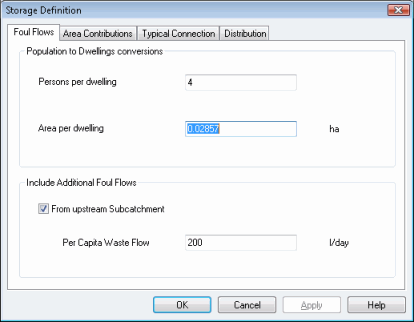

The next task is to calculate the foul only connections. These are derived from two sources:
- population - the number of connections is based on the assumption of four persons per dwelling
- additional foul flow - the number of connections is based on the assumption of 0.0093 litres per second of additional foul flow per dwelling. 0.0093 litres per second is based on four persons per dwelling and 200 litres per head per day.
The number of connections calculated for the roof area is deducted from the foul connections to avoid double counting.
So in this example the number of foul connections is:
Population + additional foul flow - roofs
= 125 + 64.8 – 62.5
= 127.3 connections
The foul only connections are converted into an equivalent connected area by assuming a housing density of 35 dwellings per hectare (or 0.02857 hectares per dwelling.) A connection length can then be calculated as before:
127.3 connections
= 3.637 hectares
= 45.46 m connection length.
The number of persons per dwelling, flow per person and housing density can be changed on the Foul Flows Page.
Figure 2: Storage Compensation Dialog - Foul Flows Page

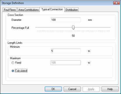

This total length is then multiplied by half the area of a 100 mm pipe to give the total un-modelled storage.
Half area of 100 mm pipe = 0.0039 m2.
Therefore total un-modelled storage = 46.25 m3.
You can choose the size of the typical pipe and how typically full it is on the Typical Connection Page.
Figure 3: Storage Compensation Dialog - Typical Connection Page

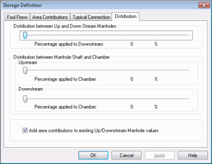

You then decide how this 46.25 m3 of storage is distributed between the up or downstream manholes and between the shafts and chambers of these manholes using the Distribution Page. By default, all the volume is applied to the upstream shaft area.
Figure 4: Storage Compensation Dialog - Distribution Page
In this example the shaft depth (ground level – pipe soffit level) = 1.395 m. Therefore the area of the shaft should be increased by
46.25 m3 / 1.395 m = 33.15 m2.
