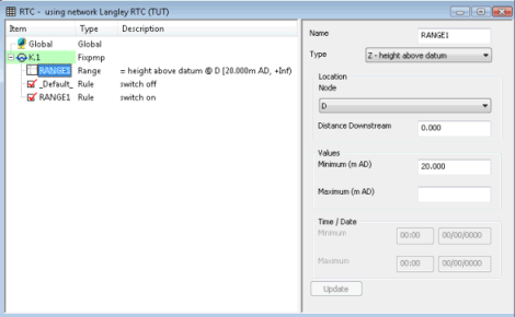

The Range pane contains the following fields:
Name |
A label to identify the range |
Type |
The Range Type (see below). Using an invalid range type will result in the range being ignored |
Location: Node Link Subcatchment Regulator Pump Definition Node/Link |
Specifies where measurements are taken for this range. This should match the label of a node or link in the network. If not, the range will be ignored.
Location: Distance Downstream |
Only applicable for measurement points in conduits (pipes or channels). The position of the measurement point from the upstream end of a conduit. If a distance greater than the conduit length is given the conduit length will be used. The upstream end is assumed if the value is negative.
Values: Minimum |
Minimum numeric range value. If blank, the value defaults to minus infinity.
Values: Maximum |
Maximum numeric range value. If blank, the value defaults to infinity.
Time/Date: Minimum |
Minimum range time. If blank, the time defaults to the start time of the event. A time range should start on a major timestep |
Time/Date: Maximum |
Maximum range time. If blank, the time defaults to the end time of the event |
