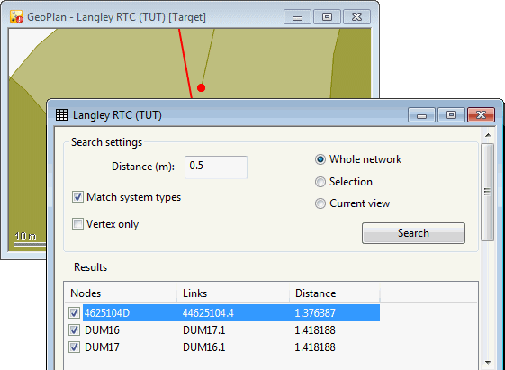

The following screenshot shows a proximity trace example:

  1. With a network open, select Tracing toolsProximity trace from the GeoPlan menu. This will display the Proximity Trace View.
  2. Edit the search settings if required:
    • Distance - the trace will look for nodes that fall within the specified search distance of a pipe to which the node is not already connected.
    • Search area options - select the area of network to be searched.
    • Match system types - check this option to only include nodes that lie within the search distance of a pipe of the same system type as the node.
    • Vertex only - check this option to search for nodes that fall within the specified search distance of a pipe vertex only.
  3. Click the Search button to list nodes that lie within the search distance of another pipe and match the criteria selected above.
