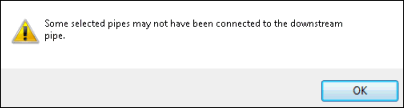

Pipe Direction Trace Warnings
Pipes may not be connected to downstream pipe
If the tool cannot trace through all of the selected pipes (and therefore not test the direction of all selected pipes) a warning message will be displayed.
This may occur if selected links to be tested are:
- downstream of the chosen pipe to be traced from
- not directly connected to each other e.g. in a subnetwork or connected via unselected links

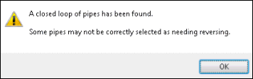

Closed loop of pipes found
If the network contains a closed loop, a warning message will be displayed.
Links that are in the correct direction with respect to the chosen downstream pipe / link, may be selected as being in the wrong direction as a result of the trace through a loop. You may wish to refine the selection of links to be tested to avoid tracing through a loop.
If a closed loop is found, the direction of links in the closed loop should be assessed manually before using the Link Reversing tool to correct direction.
