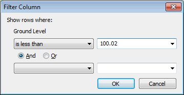

This dialog is used to set filters for which to show network objects in a network object grid window .
It can also be used for filtering data for the database items, Action Lists, Alert Definition Lists and Alert Instances Lists, which are also displayed in grid windows.
The dialog is displayed when the Filter option is selected from a network object / results / database item list grid window context menu. The dialog displays the name of the column the filter applies to (this is the column that has been clicked on).
Filter Options Dialog
A condition (or criterion) consists of a comparison operator and a value. The list of operators can be selected in the top dropdown list. The value to use for the operator can be typed in the box on the right or selected from the corresponding dropdown list (click on the Down Arrow button button) that is populated with a list of unique values from the column. A maximum of 10,000 values are allowed.
Up to two conditions can be simultaneously applied. The pair of boxes above the radio buttons are used to set the first condition (comparison operator + value) whereas the second condition is optional and can be specified in the pair of boxes below the radio buttons:
  • Select And to apply both criteria
  • Select Or radio button to apply either criterion.
