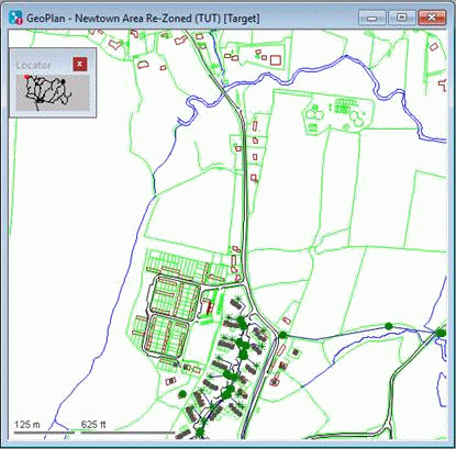

    • Zoom in closer, so that you can clearly see the housing estate to the west of K350260.
      Zooming on the housing estate of interest

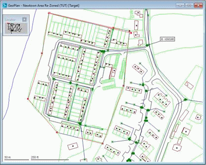

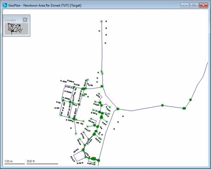

    • Click the New Polygon (New Polygon) tool. Mark out an area containing the development area to the west of K350259. If necessary, use the auto-panning feature to include areas not currently visible on the GeoPlan; when the pointer is at the edge of the GeoPlan and turns into a large arrow, click to scroll a short distance in that direction. Double-click to finish the polygon.
      Drawing the Polygon

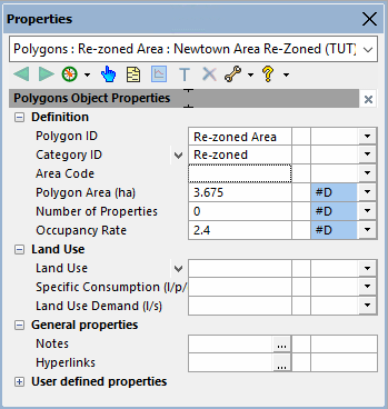

    • In the Definition section of the Polygons properties sheet, click the Category ID drop-down and select Insert new polygon category object. Enter 'Re-zoned' as the polygon category name and click OK. The Properties window shows the new category definition properties.
      Polygon Definition tab

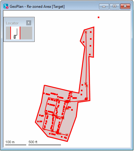

    • Use the Select (Select) tool to select the polygon. (Click anywhere inside the polygon). Use Find selection on the context menu to maximise the display.

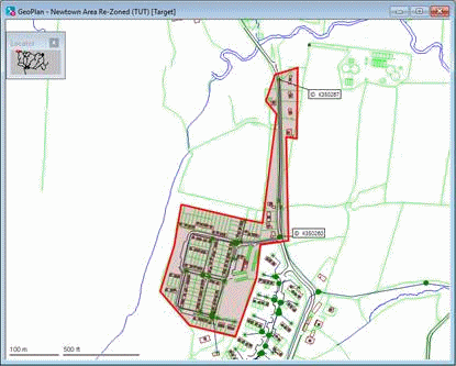

    • Use the Reshape polygon (Reshape polygon) tool to change the polygon boundaries. This time include nodes K350259 and K350260 and all nodes north of that point (as far as K350267). Click the polygon and then drag the polygon corners to new positions. Hold down Ctrl and click the polygon border to add new bend points. When adding further polygons, the points that you add will automatically 'snap' to the corners of nearby polygons, unless you specify otherwise. To turn snap mode off (or back on again) press key S or click the Use Snap Mode button on the toolbar.
      Reshaping the Polygon

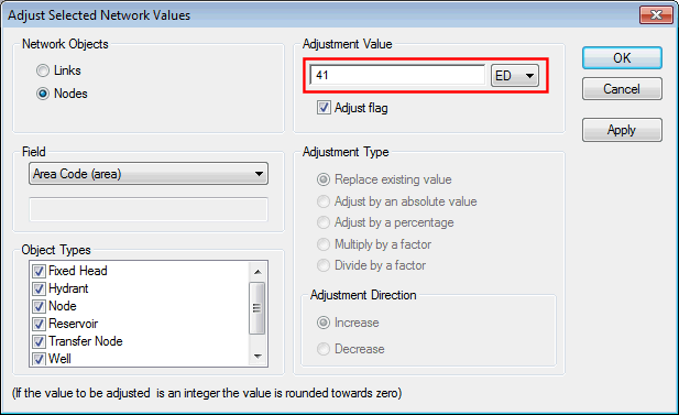

  5. Values of all the objects of the same type included in a polygon can be edited at once. Change the Area Code to 41 for all nodes in the polygon:
    • Select the nodes and links using Selection | Select objects in selected polygons.
    • Choose Selection Selection operations Adjust selected values. In the Network Objects area of the Adjust Selected Network Values dialog, select Nodes. In the Field drop-down list, select 'Area Code (area)'. In the Adjustment Value box, type '41', then click OK.
      Adjusting Selected Network Values
    • Confirm the changes. You can use this method for changing the values for any selection, not just those contained in a polygon.

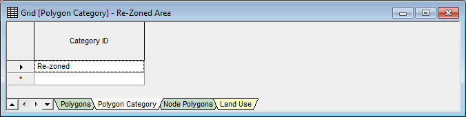

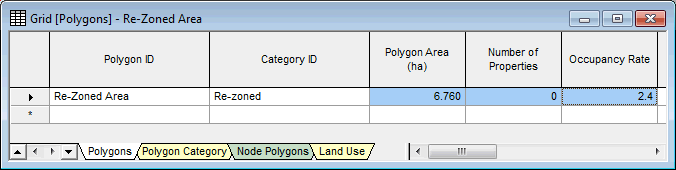

    • Select Window Grid windows New polygons window. The grid view is displayed. Alternatively, click the corresponding toolbar button.
      Polygon Grid
    • The Category ID is shown as 'Re-zoned'. Click the Polygon Category tab to see the categories. Any category can be applied to other polygons. Categories provide a means of grouping together. Each polygon can be included in only one category.

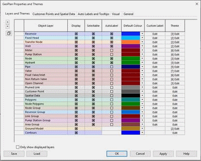

    • Right-click the GeoPlan and select Properties & Themes. The settings for the Polygons layer determine the way in which polygons are displayed. For example, clearing the Display box results in all polygons being hidden.
      Showing / hiding Polygons on the GeoPlan

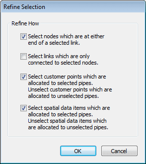

    • In the network branched in step 1), use Selection | Refine selection to check that the selected objects form a viable group. The defaults are suitable, so click OK. This option ensures that there are no links that do not have a node at each end, that any associated customer points are included (along with any other spatial data items) and that any customer points (and other items) are excluded if they have been incorrectly included in the selection (because they are associated with links that are outside the selection).

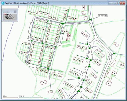

  8. Now that the polygon has been copied onto the new network, we can delete the re-zoned objects:
    • In the original network (network branched in step 1), select Selection Selection operations Delete all selected objects and confirm the deletion.
    • Accept the defaults that are offered.
    • Click No when asked if you want to leave allocated demands at nodes.
    • If the selection did not include the connecting pipe (which now has no end node), delete it.
    • The zoned area has now been removed.
      Original network without the Polygon
