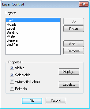

MapX
Use this dialog to choose how layers are displayed on the GeoPlan window when using MapInfo MapX as the GIS component.
The Layers box lists the layers that are currently selected for display. The layers are added to the view in the order shown, with the layer at the top of the list being displayed above all other layers.
The following buttons change the layers that are displayed:
Up |
Moves the selected layer higher up the list. |
Down |
Moves the selected layer lower down the list. |
Add |
Adds a new layer, based on a MapInfo table. |
Remove |
Removes a layer from the display (the data is unaffected). |
The following properties of the display can be changed:
Visible |
The layer is visible. |
Selectable |
Items in the layer can be selected. |
Automatic Labels |
The system adds a label to each item. |
Editable |
The underlying data in the layer can be edited on the GIS Layer Information dialog if this box is checked. See Viewing and Editing GIS Layer Data for more. |
To alter the display properties of a layer, click the Display button to show the MapX Display Properties dialog.
To display layer data as labels, click the Labels button to show the MapX Label Properties dialog.
